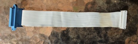

For now I am just trying to get into the monitor since the CCS 2810 has a built-in ROM. So, I started the main unit up with no boards to check levels - all voltage supplies are spot on. The only cards I have installed currently are the 2810 and the IO-8 (since it's port A was configured for Terminal 0). I jumpered the 2810 to run the ROM (ROM EN, JMP EN, JMP ADDR SEL set as indicated in the manual) but am getting nothing out on the terminal. Do I have to use the 2810's internal serial port in order to use the ROM? Currently SER EN is OFF. If so, how would I construct a cable? (the board has a 26-pin header). I depending on what cards I install, I will get the HALT LED come on. In the current configuration it does not come on.
I made the cable for my 2810 by crimping a 26 pin IDC connector to flat cable to 25 pin D-shell female connector. This gets you a 25 pin D wired as a DCE.

So is that right that the monitor will only work with the 2810's serial port? Could you share a picture of your cable? I want to make sure I get the directions right.
Yes the CCS monitor expects to use the serial port on the 2810 board.
Addressed at 20h
Photo of cable may be attached.... can't really tell
joe

I don't have any crimping tools - what would I need to build a cable like this? I could I just splice it by hand? Are the pins just hooked up 1:1, and it looks like you just leave off #26 from the cable? Do I really need to hook up all 25 lines or only like 8 or 9 of them?
I do have these - that should work, right? Do I need a special tool or just push it down by hand? https://www.ebay.com/itm/174346909156 I just seen in a video you can use a vise.. I'll give that a go.
For the D-shell connectors I just crimp them in a vise. I use a "scrap" connector
(no pins just housing) to protect the male pins. You just mate them and apply
pressure with the vise.
For the IDC connectors the pins are not exposed so just put in the vise and squeeze.
All 25 pins are not needed. You really only need 3 wires if you are not doing flow control. 2
Dshell 26PIN
2 3 in
3 5 out
7 13 ground
It just looks a lot cleaner to use the crimp stuff.
joe
