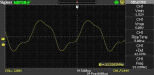

Ok so no obvious source of the issue up to this point. For what follows I have used a 100 Mhz, 2-channel digital sampling oscilloscope (a Siglent SDS1102CML).
Clocks:
- The clock generator is (I think) a UM9515-01 but I could not find any datasheets for it. Similar generators usually have the clock output on pin 8 so I checked
that and it does have a 33 MHz wave. It's not super clean:
- The ISA bus has good OSC (at 14.318 Mhz) and BCLK (at 7.159 Mhz, ie OSC/2) signals

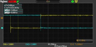

ISA I/O reads/writes:
- The BIOS code contains several IN and OUT instructions from the very beginning. Most of these are chipset-configuration related (cf the chipset manual) so it is possible that the chipset traps these and does not broadcast them on the ISA bus. However we should at the very least see the 0x80 diagnostic OUTs (even if my dodgy POST board does not show them).
- to check this, I simply set the oscilloscope to trigger a single acquisition on the falling edge of IOW\ (B13 on the ISA connector)
- results: nothing! not a single trigger... not good. Same thing with IOR\ (B14).
Now the hard part... pls shout if I got any of the details wrong.
So we know that upon RESET being deasserted the 486 CPU is supposed to start instruction fecthing and execution in Real mode at physical location 0xFFFFFFF0 with CS:IP set to F000:FFF0. The chipset should map this to the onboard ROM, which contains the BIOS. So the first thing to check is whether the ROM chip is being accessed correctly and with the right address (ie starting at 0xFFF0 as the chip has 16 address lines). To do this I:
- set the oscilloscope to trigger a single acquisition on the falling edge of RESET (B2 on the ISA connector) on one channel
- use the other channel to acquire the following signals, one at a time: Chip Enable (CE\) and Output Enable (OE\) on the ROM chip, and SA0 to SA15 on the ISA connector
- I have checked and the address pins on the ROM chip are directly electrically connected to the ISA connector lines SA0...SA15 - no buffers/transceivers in the middle. The latter are much less fiddly to sample with my probes.
- I acquire about 80 usec of data at 250 MSamples/sec (on each line), ie the first 70 usec after RESET is deasserted
- I transfer all the waveforms to a laptop and in Excel I crudely identify the time positions of the falling edge of OE\ and "read" the level on the address line waveforms at those times
- I check that CE\ is asserted whenever OE\ is asserted (except a tiny part towards the end), so I don't have to worry about it
- I also make a mental note to buy a logic analyser or a mixed signal oscilloscope as the above is a fairly laborious process...
