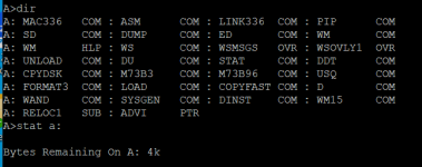

Hello All...
A update on my side. Recently I started again with the BBII. Topic is to have WordStar running on the machine. Finally I have it running !! Let me share with you where to find a version of WordStar, and I had to do some conversion steps too:
1) First browse to the following link:
http://www.retroarchive.org/maslin/disks/bigboard/index.html
2) There you see a file called: 60kcpm22.td0. Download the file to your PC. This is a bootable disc
3) Use HxCFloppyEmulator to convert the "td0" file into a 60kcpm22.img (raw) file
4) Open again HxCFloppyEmulator and press the button: "Load RAW image"
5) Use the following settings:
Bitrate: 500000
RPM: 360
Number of Tracks: 77
Sector per track: 26
Number of side: 1
Sector size: 128 bytes
and press the button "Load RAW file", and select the above mention: "60kcpm22.img"
6) After selecting the file you will go back to the main window of HxCFloppyEmulator
7) Press "export" to create a "60kcpm22_img.hfe".
8) Leave HxCFloppyEmulator and rename the "60kcpm22_img.hfe" to "DSKA0000.hfe" and insert on SDcard.
9) SDcard in HxCEmulator and boot disc with BBII.
At the end you will have the prompt and type in "ws.com"
Two topics left on my BBII:
- Parallel interface needs to be checked, new IC sockets etc...
- SASI interface is new for me. Would be great to have it running with a HardDisc..
