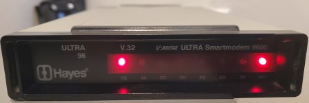

I like having a wifi modem on my older equipment, but missed the blinky lights. So I did this with a old hayes modem.
I already did a fork of Zimodem for a different project, so lets edit the source code, add 3 more leds, add a buffer for the signals and get to work.
Source code and schematics are here.
https://github.com/dabonetn/ZimodemESP8266Leds
I removed all the components from the original board, except for the LEDS, the resistor packs for the LEDs, the serial port, and the power switch. I designed my board to use the Pololu rs232 board, but had issues with it, so I used a Aibans Breakout (???) rs232 board I bought off amazon. Traces are cut and removed from the original sockets, and the 2 board are mounted using header strips. The esp8266 module is a D1 Mini pro to get an external antenna because the hayes case is metal sleeve.
And here we have the magic, lots of kynar wire, some larger wire for the power and a helping of hot glue.
Designed and 3d printed some mounting brackets for the antenna and power jack. +5, 1.5a or better.
And the front.. Blinky blinky... :)...
So, good use of a old modem? Or a horror that shouldn't exist??
