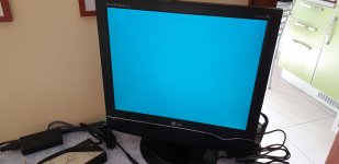

But unfortunately it didn't last for long and after about a minute the TI logo disappeared leaving me with a light blue screen.
The computer seems to start and initialise correctly as the usual starting beep is audible.

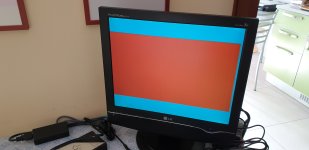

If the space bar and then the '1' key are pressed (to start TI BASIC) an orange rectangle appears on screen.
Pressing random keys followed by 'Enter' makes the computer to beep as expected for a Syntax Error.
