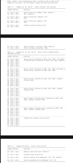

So I wired up a loopback test and it passed all the tests.
Most generic three button serial mice (other than Logitec) are also Microsoft serial compatible. These usually have an alternate "Mouse Systems" compatible mode, either a switch or holding down a mouse button at startup, that switches to the Mouse Systems protocol and can use the middle mouse button.
Also, when running CheckIT, note the address and IRQ of the serial port. On the off chance those are not configured to standards, some mouse drivers may have issues with it.
Passed all the tests. The screen is a bit hard to read, gas plasma with lines, but I think it says 03F8 and IRQ3
Well... COM1 should be at 0x3F8 / IRQ4 and COM2 should be at 0x2F8 / IRQ3. If they are not, you have a non-standard configuration and might need to tell your mouse driver.

Hm wonder if I missread. Attached a photo of the docs, everything is default now.
Edit: gonna double check the jumpers too.
And no I haven't tested them myself, don't have a functional second pc with a serial port :/

Try to run "CTMOUSE /S13", which should force it to use COM1 with IRQ3.
THAT SOLVED IT!!!
Thank you so much, this saved me so much headache and I would never have solved it on my own.
The question is though, why is it IRQ4? Docs claim it should be IRQ3 as default. Would be nice to solve the core issue instead of workarounds.
I'd double check the jumpers, make sure they are all making good contact, and in the right positions. Frequently on I/O devices one of the jumper sets is just for IRQ and may be set independently of the I/O address. A previous owner may have changed jumpers for a variety of reasons.
Because IBM said so, back in the early 80s. They defined four standard serial ports:
  • COM1 at 0x3F8 and IRQ 4
  • COM2 at 0x2F8 and IRQ 3
  • COM3 at 0x3E8 and IRQ 4
  • COM4 at 0x2E8 and IRQ 3
Note that COM1/COM3 and COM2/COM4 share their IRQs, which means in practice only one of each pair can be used at a time (or at least one of the ports is operated in polled mode, which does not use the IRQ). That is why some cards allow setting non-standard IRQs, which was especially important for terminal servers.
At least now we have identified the problem and proven that nothing is broken. The proper fix for you is to set the card's jumpers to a default configuration. (You can also set it to COM2, but some applications will be very confused if COM1 is missing.)

I´ll double check em, the visible jumpers are default but there are two that´s hidden under a plate. I haven´t checked em with a multimeter though.
In the next couple of days I´m going to pick it apart to see if I can make the screen a little better so I´ll check then.
