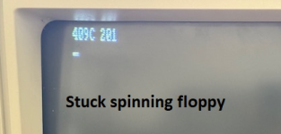

I recently acquired an IBM 5150 Type B (64K-256K), which on first couple of boots showed a POST error PARITY CHECK 2 (maybe with a 201 also).
But then the power supply went dead. I looked around a noticed the fan twitch on power on, so it looked like it going to over-current shut-down mode.
And indeed, when trying different cable unplugging combinations, it was found that diconneting P9 connector (the one with +12v -12v) the power fan started working and computer booted.
I could not find anything specific to the P9 connector or 5150 functioning without it. (*)
However, it still shows POST errors 409C 201 but proceeds to cassette BASIC when a floppy disk is not inserted. Keyboard works fine etc.
When a floppy disk is inserted it seeks and then either spins the disk forever or stops spinning, but the keyboard in unresponsive (even Ctrl-Alt-Del).
It has two standard DS/DD full height floppy disks. If I disconnect the data cable from the second disk B:, it may occasionally show POST error xx 301 (stuck key), and proceed to boot from disk A: and execute AUTOEXEC.BAT. But they keyboard is unresponsive (even to Ctrl-Alt-Del). Good news is that that both drives seem to be working in such "configuration", i.e. the other is disconnected. The termination resistor array has not effect on the outcome. The 1E shunt switches in both drives are in DS1; and the data cable is twisted on the second connector - a standard IBM configuration.
Also SW1 is set to two floppy drives. It didn't want to boot from floppy with the 1 drive SW1 setting.

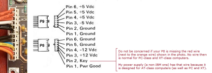

P9 should be the -5/+5v side. I’d back up a little and first check the main board for shorts on that 5v side.
On your Rev.B system, -5v is only used for the cassette amplifier circuit and possibly the floppy controller if it’s an early version. The +5v is used by most ISA cards. You should check out Minuszerodegrees.net, a well maintained site with fantastic information.

You have your P8 and P9 confused. P8 is the one with +12V and -12V on it. Looking at one of the photos, I am pretty sure that it is P8 that I see disconnected.
That certainly explains why the motherboard powers up. The motherboard is getting +5V via the still connected P9.
Looking at the diagram below, which is removed. P8 or P9 ?
A 201 error is a RAM related error.
On your particular computer motherboard type, 5150 64KB-256KB with 10/27/82 BIOS, the "40" portion indicates an error at RAM address 256 KB.
In the photos, 256 KB is the most that you have, a fully RAM populated 64KB-256KB motherboard.
As expected, the POST is failing when it tests non-existent RAM.
Was it a RAM card that you removed from slot #3 ?
If not, it becomes a case of working out why the power-on self test (POST) believes that there is more than 256 KB of RAM in total (motherboard + RAM card/s).
Possibilities will be:
- Incorrect RAM related switch settings on motherboard - not set to 256 KB. There are some switches in block SW1 and some in block SW2. See [here] for the settings on a 64KB-256KB motherboard. Per [here], do not confuse ON with OFF.
- Faulty RAM related switch in SW1 or SW2.
- Switches are good, but not the circuitry that reads the switches.
Regarding the last two. You can get into Cassette BASIC, and so you can use what is shown at [here] to verify that the switches are being read correctly.

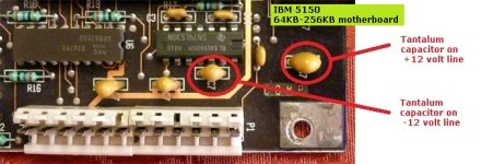

... it was found that diconneting P9 connector (the one with +12v -12v) the power fan started working and computer booted.
Assuming that this is P8 rather than P9:
P8 supplies +12V, -12V, and the POWER GOOD signal, to the motherboard. Usually, removing P8 from a 64KB-256KB motherboard results in the motherboard not starting, due to the lack of POWER GOOD. But I am aware of some motherboards that will start without POWER GOOD, and your motherboard must be in that category.
There is like a 99.9% probability that the cause is a short-circuit tantalum capacitor on either the +12V line or the -12V line. It is VERY common, as seen at [here]. If this is the cause, the procedure at [here] will lead you to the capacitor (and provide replacement details).
This is booting to DOS. The following is possibly what is going on:
As explained earlier, the POST/BIOS believes that there is more than 256 KB of RAM present. As a result, so does DOS. When DOS boots, possibly depending on the scenario, DOS may try to use RAM that does not exist, and 'falls over'. This is not an issue for Cassette BASIC, because that only uses the first 64 KB.

Firstly, sorry for confusion between P8/P9. Yes, it's the 12v P8 that causes the no-power condition, and unplugging P8 makes the power supply spin the fan again (and I did measure voltages when the fan was out, and there were only residual sub 1v on various power rails).
I was just working through the info about the 12v tantalum cap (the C7 in the corner in my case). So it did have a short across it's + and -, so I happily snapped its leg, then realizing it's a three-leg, the second leg. And the result was the same: connecting P8 back caused no-power. And measuring the + and - of where the C7 cap was still showed a dead short (0 ohm).
(I also took out the remaining two cards (the floppy controller and SysDyne! CMG-P), and again P8 was causing no-power.)
So something other than the C7 tantalum cap was shorting the 12v rail. I then followed the referenced
... and also found about the cap on the second 12v rail. So both +12v and -12v have similar tantalum caps.
I measured across the second cap, it was showing a short. So I snapped the second 12v cap. Connected P8 -- and it powered! -- Thank you for creating those Diagnostics pages and sharing them.
So that was one down and two to go. In the following posts I'll address the RAM error and the drives.

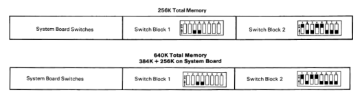

Re: the RAM POST error 201. Yes, the switch RAM setting is wrong, because the removed expansion card was a RAM/Parallel/Serial/RTC card, which was giving POST error 9004 201 and PARITY CHECK 2.
So I removed it to narrow down the diagnostics. And I did not adjust the switch settings.
For the previous configuration with the RAM/etc expansion card and on-board 256K,
- SW1 has 3 and 4 off (correct)
- SW2 had 10110 for positions 1-5, which is 640k total = 384K + 256K on board
For the current configuration without the RAM/etc expansion card and with on-board 256K, it should be
- SW2 having 10011 for positions 1-5, which is 256k total = 0K + 256K on board
So after adjusting the RAM switch settings, POST has not issues. And it boots to PC-DOS 2.10.

After setting the RAM switches, it now boots normally. And there are no POST errors.
