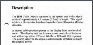

While investigating ways to convert my North American-procured 5153 from "120 VAC" over to 230 VAC, I noticed the design of the internal switching power supply may not actually preclude handling both input voltages. Looking further, I found this quote in the manual on minuszerodegrees.net:
attachment.php
On the back of my particular unit it states 120 VAC and according to the SAM's manual the EMI filtering near the IEC connector has 120 VAC caps but I see that on a pic I took of the PS board a few years ago that it's additional mains filter uses 250 V caps.
Another concern is the degaussing coil and series PTC.
Has anyone operated their 5153 on both mains voltages and what is the marked specification of that unit?

I thought it went by Model No: ie: 5153001 = 120VAC only, 5153002 / 003 = 230VAC, Ive just had a look at the back of my 5153002 model and the rating is:
50/60 Hz
100 - 250V~@0.95A
I have never tried it on 120V as i don't own a step down transformer.
50/60 Hz
100 - 250V~@0.95A
My 5153002 is similarly marked.
I just now powered it up using a 240V-to-115V step down transformer, and as expected for the marked voltage range, it worked fine (displayed video as expected).
Right ... thanks guys. My unit is only marked "5153."
As you might imagine it takes a great leap of faith to plug a monitor marked "120V~" into 230 VAC but I did that after removing the PS and powering it on the bench against a dummy load. No need to risk the whole monitor.
Much to my relief it worked fine although I noticed afterwards that the 120uF primary smoothing caps installed (wired in parallel) were only rated at 200 V rather than the 400 V required when running at 230, and as specified in the Sam's schematic. Those have now been replaced with 2x100uF parts from Jaycar and the PS is back in the monitor ready to test the one remaining unknown, the degauss circuit's PTC. Just switched it on and so far all is good, no smoke.
It's clear that Tatung designed the monitor for world-wide voltages but took a few liberties in production on 120 V versions. Three EMI cross-line caps also needed upgrading to 250 VAC parts and I hope there is nothing I've missed. It also ocurred to me that when Sams writes a service manual that they only measure and document what they find in the particular example they tear apart and are unable to quantify that relative to the original design specifications. In the schematic there are two hints but nothing specific that the PS can handle 230 V, where primary PS DC voltages are doubled over what they quote as test values.

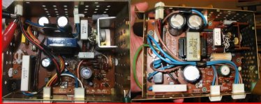

I just had a quick look inside an old 230V 5153 PSU i have which has suffered heat damage to the PCB and R805 is 5W 30 Ohm
Great info, thanks! Interesting that it's exactly doubled. I thought of changing it but was unsure which direction to go, or if I might damage something.
This handily negates my theory that the power supplies are exactly the same and I'm lucky that mine has not gone up in flames. I would expect that there are other minor differences in resistor and cap values in the area between R805 and T802, but the circuit design is likely the same.
As best as I understand, the circuit consisting of the upper left coil of T802, via R805 and C821 provides positive feedback to the switching transistor Q801, encouraging it to oscillate, modulated by a voltage regulation circuit to the left and passing through the overload crowbar circuit to the right.
I just got a Pic of mine, Not very good, crappy old camera. Little difference in layout to yours.
Compared side by side the board layout has some differences. If the p/n is what it appears, the same, yours is a later revision, -2.
a) the transformer is the same p/n (phew!) but is it's core is turned 90 degrees.
b) the enclosure has more holes, especially at the top (right in photo.) You can see both suffer from high temperatures.
c) the lower connectors and 10 watt inrush current limiting resistor are relocated.
d) the power switch circuit has another set of conductors and 2 more connector contacts (lower right.) The wires now run so close to R805 they had to install a insulating tube over the resistor.
e) there's a green wire exiting to the left, presumably a ground wire for the blue Y2 EMI caps, which look a bit larger as well, perhaps the reason for the change.
Three large electrolytics on mine are smaller because they've been replaced. It's anyone's guess if the schematics are identical or revisions have been made to the design.

I have the psu on the right, the TPW246 transformer IS different to the one on the left, it is marked B after the model and has less connection pins from the earlier version.
the earth wire is from the isolated secondary 0v and is just connected to the chassis on the right psu... the right psu isin my 5153002 100 to 250v marked on the back
