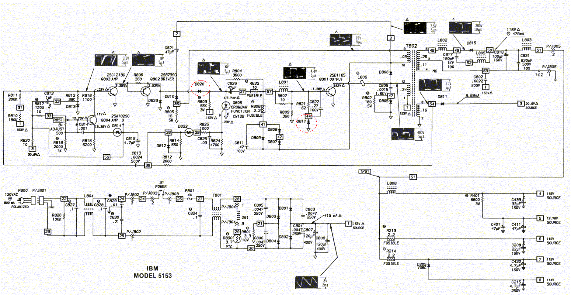

I have managed to find a diagram online but it was not quite the same! so over the weekend I have modified it so now the circuit IS the same as the PWB-811 board BUT the diodes are what was on the diagram originally! the 2 zener diodes ARE updated to what my board contains as well as the transistors, the resistor values have been tweaked as well as these differed slightly. hers is the diagram so far......
So basically it took out D817, R821, R809, R823, D820, Q802 2SB739 and of course Q801 2SD1185!
it is a Tatung PWB-811 psu

Well thanks to everyone that PM'd me I have now found out the 2 grey resistors marked 1100 and 1229 are 10r and 2.2r 1/2w fusible resistors
I have now opened up the counterfeit transistor 2SD1185 and indeed it is very fake! when it blew it melted the internal connections off from the semiconductor to the pins! no wonder I got a totally open circuit from it once it blew! normally they go short circuit when these beasties go! going to open up the original transistor tomorrow then will post what the differences are and what to look out for once I can post without having to wait for the post to be approved! (10 post count) so if anyone is intending to buy 2SD1185 transistors watch out for the fakes on the market!

I have now managed to identify all except one diode!
looks like it has a '3' on it and a curved type of 'T' it is Do-35 case style and resides in position D820 in the power supply board. any one have any idea what this diode is?? it is all that is stopping me getting this running!
any help would be great!!! many thanks in advance

One may be able to suggest a replacement based on where D820 is in the circuit ([here]).
OK well on doing some research, I have found the diodes with just a black band such as D812, D813, D817 to be 1S1555 (35v 300ma general purpose diode) and the marked diode with a 'T3' D820 to be a 1S1553 which has a 70v 300ma rating general purpose again, so easily able to substitute both with the more common 1N4148 diode!

Don't get these! they are far too small! discovered it is 1w fusible resistors actually fitted on the pcb, I managed to work out the numbers written on them, the first (1) is for 1w then the value (10) and then the (0) is the multiplier, so 1w 10r = 1100
now for the 1229, well again the first (1) is for 1w, then (22) the value and because the multipliers normally go from 0 to 6 and go to the right to add zeros, they have used (9) to move the decimal place one to the left! so the value becomes 1w 2r2
these are both fusible resistors, easy when you know how!! I deduced this from 120r I had in my spares box of the same type marked 1121 and the physical size of them!

New fusible resistors have arrived, I ended up buying NFR1W10R and NFR1W2R2 fusible metal film resistors
once bent into shape and length..
not much more to do now!!! :onfire:
Everything now fitted, powered it up with my dc current limited power supply! at just over 70v it started to spring to life and at 95v got the full 115v output from it! it seems to regulate fine and am now back to where I was originally with it! just got to pluck up the courage to apply full 230v ac to it at somepoint! but for now I am pleased it works again!!
Many thanks to everyone that helped me along the way!
Have now turned up the dc power supply to 300v and it survived fine! so it does look like I now have a genuine 2SD1186 transistor!
