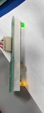

Now I am in a situation where my FDD are working but, all of my ESDI drives are not recognized by mainboards.
The ESDI drive itself receives power, spins and can hear sounds of seeking. The Diode 15 also illuminate when machine is powered on.
I can clearly hear HDD powering up, spinning and trying to seek. But Front Panel LED does not illuminate HDD diode which should illuminate if HDD is working or seeking during operation.
It seems like after RAM check, the mainboard is trying to boot from HDD, but after a moment, it just spins FDD and boots with my diskette.
I have tried to change HDD from 120MB to 60MB and both are not recognized by mainboards anymore. When it was running okay with WIN95, WIN3.11 back in November.
Do you guys have any suggestions? I have never encountered with this error with other PS/2 Machines and ISA computers.

In addition, when I first boot up with working FDD after resoldering, the disk was placed next to PSU to test functionality. The head is definitely scanning, but did not read anything.
I fixed this issue by displacing away from PSU which creates high EMI and FDD worked very well.
Do you guys think the HDD would have same effect?

I do not have the tape at this moment. So I placed PSU away from HDD.
And HDD data transfer is now working very well. I will ask my professors if they have any EMI shielding tapes so I do not have to spend more just for few feet.

The EMI shielding tape worked very well and now I am not receiving 10483 POST code.
