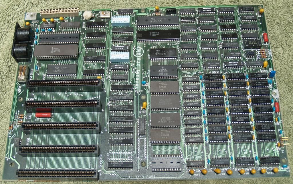

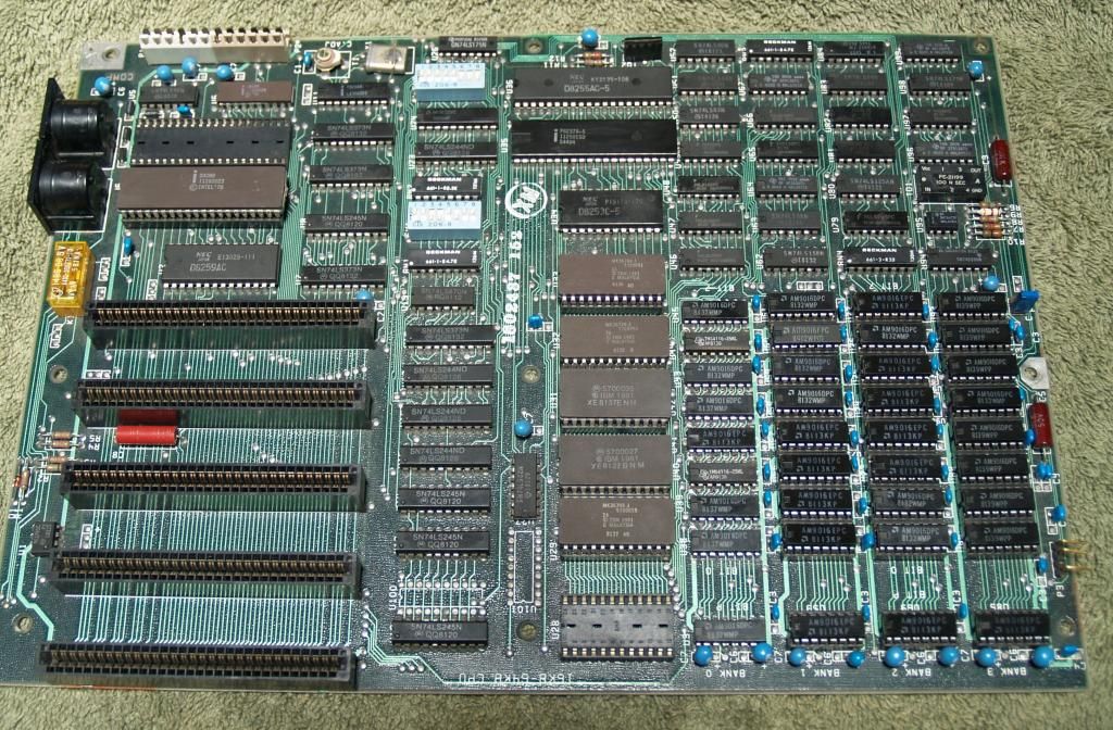

I have two 1981 motherboards. One has fixed chips (not counting removable RAM) with date codes from 8022 through 8137... the other has fixed chips with date codes from 8114 through 8140. On the underside, the PCB's themselves also have a date code machined on the back: 8135 and 8138... both are also marked 94V-0, Pc-A-0 in green with the numbers 5000866 soldered into the corner between the power supply plug and keyboard plug. There are noticeable differences between components on the two (color of the board itself, color of relay, color of capacitors, design change in the potentiometer near the power supply plugs...). How can I upload high resolution images to this site? Would anyone be interested in these photos?

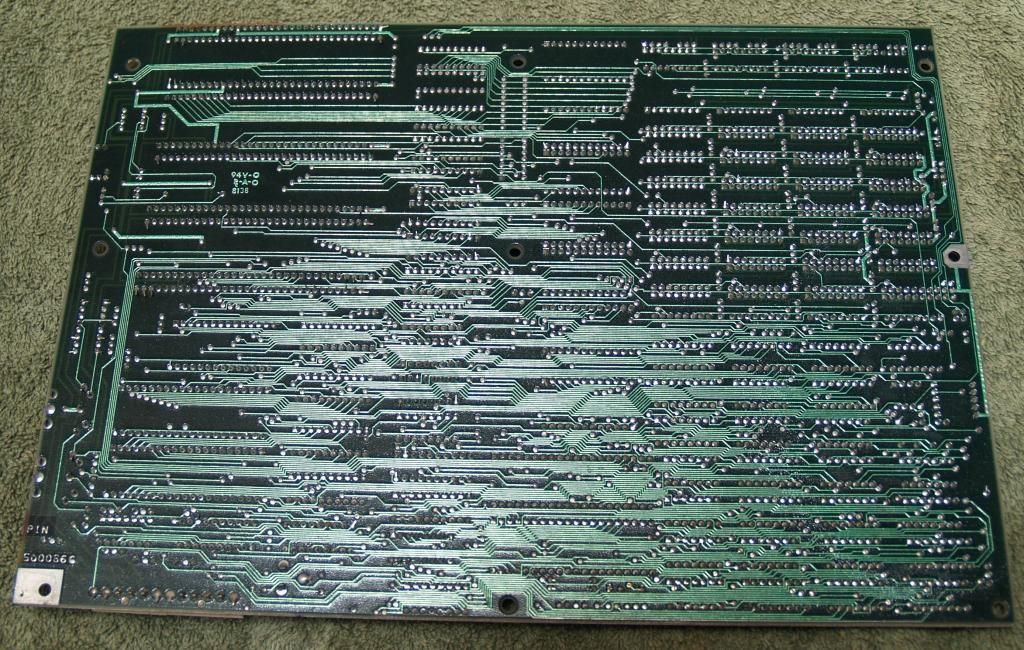

EDIT: this thread was originally titled "possible pre-release build???" That question has been answered definitively. PCB of the earlier machine was manufactured in week 35 of 1981 so the motherboard PCB was created the week of August 24, 1981... early build, but not pre-release.
Don't. It just makes it so that someone has to log in to see it - and that's a nuisance. :) It's generally best to host images elsewhere and just link. I find photobucket works, but there are many more free services. The thing about those services is that it saves hosting high bandwidth items yourself - or here, for that matter.
I finally figured this out... Here you go. If you click on a photo and then download it by clicking "options", you can zoom in considerably.
