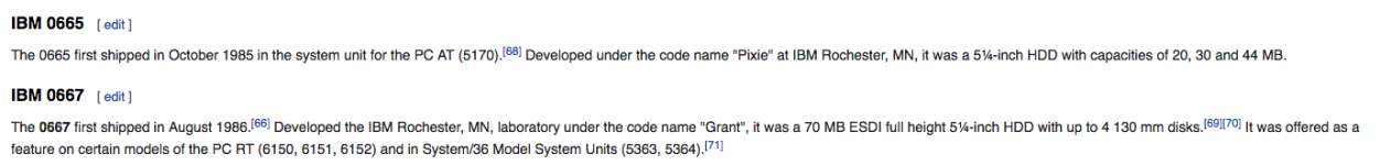

is the 20 pin disk drive cable connected to the motherboard or to one of the IBM cards like the ones in the pictures.
i'm wondering if MFM disks were supported with a different disk controlller

Yes, the 5364 could have 40 MB (0665) drives with an ST412 controller, or 70 MB (0667) drives with an ESDI controller. I didn't know how to identify which controller was which (without looking at the drives) but I must've overlooked the WD2010 in mine. Not sure what the ESDI model uses; I haven't seen one myself.
The 0665-53 isn't that uncommon, they were also used in the PS/2 Models 60 and 80, and (briefly) in the RT-PC.
