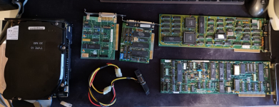

After many years scouring local ads and such, I was extremely lucky and happy to score a 5160, very rare around here, 10 minutes from my home. My very first home computer in 1987 which started it all when I was 5 years old! :)
Machine was in a beautiful state, not used for many years, but looking very good. Main unit only, has both an EGA card (yay!) and a VGA Chips card that supports 8-bit, wonderful! No screen or keyboard, I'm not complaining it already felt like striking gold and I should have everything needed at home to at least make sure it work, even if I'd love finding a 5154 and a proper IBM supported keyboard at some point (any hint for those, hit me up :D)
Some deep cleaning, visual inspection, and PSU check later, I'm in basic setup mode to start it up for the first time (FDD controller, beeper, VGA card, keyboard). Starts right up, but "301" error showing up on top. 640kb checked fine so that's nice. I have no "true" XT keyboard so using USB4VC in XT mode. F1 does nothing when prompted after RAM check. Activity comes up on the USB4VC, and numlock + scroll lock do light up the keyboard LED so something is going through. Removed the USB4VC and tried about all my old PS/2 keyboards with a passive PS/2-DIN5 converter, and found at least 2 that seem to support XT as they light up with numlock. But still, 301 on boot and F1 does not work.
Flashed the BIOS to 05/09/86 (just why not), also tried to short pins 2 and 4 in the DIN5 connector to go in maintenance mode, which worked fine, computer booted in basic.
Checked continuity between the 5 pins of the DIN connector to the motherboard, all seems fine.
I think that's pretty much it...and thought I'd look for some guidance now as it seems it could be the keyboard controller that is faulty and we're entering the territory where it will all be quite new to me. I should have all hardware necessary, including an oscilloscope that I bought with the hope of teaching myself some electronics but I'm not there yet, and only have surface-level understanding of schematics and how I should test the keyboard circuit, so would need some precise instructions and hand-holding.
I'm adding some relevant pictures and looking forward to hopefully give a new life to this piece of history!

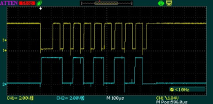

What is suppose to happen is shown at [here].
So the first thing to look for is, via oscilloscope, the 5160's POST causing the CLOCK line to go low for about 20 ms. I don't have an oscilloscope photo of that.
Following though, is an oscilloscope photo of the keyboard's response, which is the byte of AA hex. Top trace (1) is the CLOCK line. Bottom trace (2) is the DATA line. The zero volt levels are where you see '1' and '2' on the far left.

Mmh I've been trying to measure around the KBD_CLK and KBD_DATA pins but not making much sense of it. I'll add a few pictures and a video of what I'm doing so hopefully it can optimize the help!
Setup attached. So I'm measuring pins 1 and 2 directly on the bottom of the DIN connector.
And here's a short video of what's happening:
Thanks again!

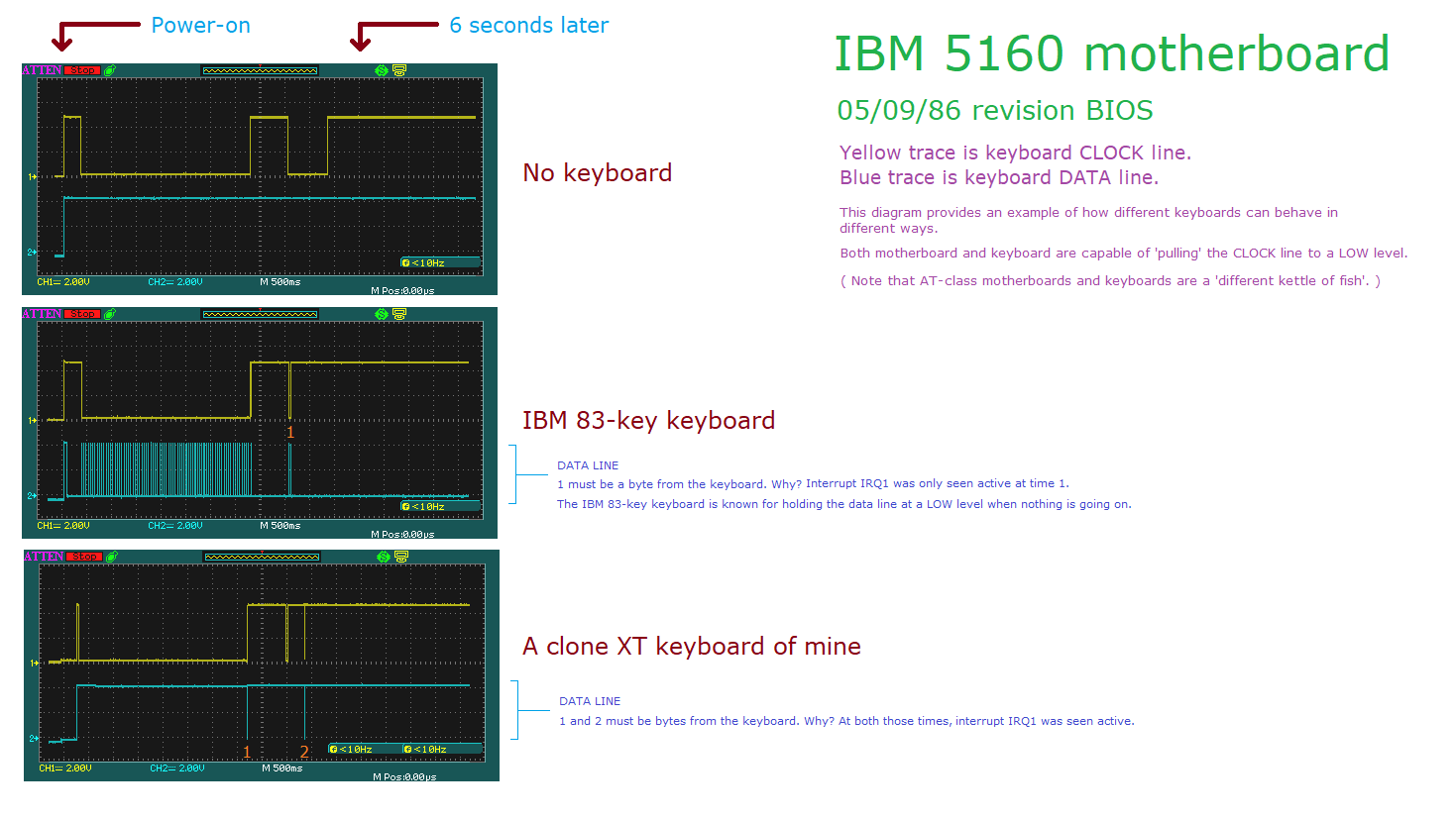

I brought out my 256-640KB motherboard, fitted with 05/09/86 revision BIOS ROM's. No keyboard. Oscilloscope monitoring the DATA and CLOCK lines in the motherboard's DIN connector.
I see what you see.
Straight after power-on:
- The DATA line goes to HIGH, and stays at HIGH for the duration.
- CLOCK goes momentarily HIGH twice, then goes permanently HIGH at about the time that the 301 error appears.
Shown in the top capture of the three in the diagram at [here]. Yellow line is CLOCK, blue line is DATA.
The second and third captures show how different keyboards can behave differently. For example, the IBM 83-key keyboard is known for holding the DATA line at LOW.
IRQ1 being active is an indication that a byte was received from the keyboard.
Captures done by setting a timebase of 500 ms/div, then manually triggering the capture (via start/stop button) very soon after I turned on the computer.

Correcting my lack of precision - "clock never goes high again" is wrong, it does go back to high once 301 is displayed and RAM counting has started. But on your graphs it looks like it's way quicker.
For what it's worth I measured it at U29 pin24 and it looks exactly the same.
(PS: just a sidenote for a newbie question about scopes...I had to go to 1s/div, or I wouldn't be able to capture the whole thing at 500ms/div like you did..is it a setting, control or something I've been doing wrong?)
On yours and mine, the second 'hump' on the CLOCK line starts about the 4 second mark.
But my oscilloscope has 18 divisions in the time domain, and yours has 12.
