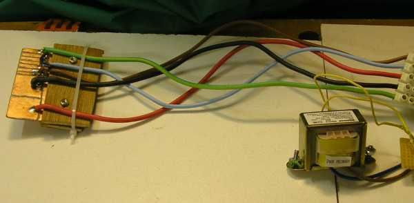

To substitute for the edge-connection fingers of the original PSU board, I made a "plug" from a piece of double-sided copper circuit board cut to size, using a hand engraver to outline the "fingers" on both sides. Though effective, this is a bit messy-looking. For a neater job, it might be possible to find a bit of commercial proto-board with appropriately-spaced fingers. The +5v and 5vGND rails have 5-6 fingers each, but one wide "mitt" representing each group of fingers saves a lot of cutting and soldering and works just as well (photo).
All GND fingers can be common, but remember that the "12v GND" on finger J should NOT be connected.
The five rails to be connected are +5, +12, -12, -23 and GND. Only five wires are needed.
Space is tight inside the VT100 chassis PSU cavity, so I soldered the plug fingers to about 20cm of colour-coded wires, with the other ends in one side of a pluggable screw terminal strip that could easily be reached from outside the chassis when the "edge connector" plug is in its socket. I could then put together the matching terminal strip socket with the outputs from the ATX and from the improvised -23v supply.

The components of the -23v supply circuit mount on a small piece of perforated circuitboard, which in turn is mounted on a piece of structural board (I used 3-ply) cantilevered out from the brackets holding the new PSU (photo).
To keep the 24v transformer away from the CRT neck, I bolted it directly to the inside bottom corner of the VT100 PSU chassis cage. This required leaving the AC mains primary leads of the transformer long enough to reach the mains power input connector block at the other end of the cavity, and the secondary 24v leads long enough to reach back to the -23vdc circuit board.
