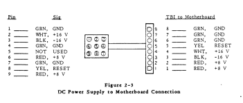

So the motherboard appears to have the original 9-pin connector that seems to be wired exactly as the 1983 "Series 5000 Microcomputers" manual says it should be wired. I was planning to provide all of the voltages outlined here (but undervolt it to 7.5v and 15v/-15v because I'm told the cards will work just fine like that and the regulators are a lot happier and generate less heat). I do have a dual power supply that can provide the required negative voltage.

So I managed to get some power hooked up today. First I made sure that the caps on the motherboard were good. Then I hooked up the Mean Well power supply modules I had, and made sure that the ground, 8v, 16v, and -16v rails (7.5v, 15v, and -15v in my case) were sitting at the proper places on the motherboard, and in the card slots.
Before putting any cards in the motherboard, I checked out the CPU card, the memory cards, and the IO cards to make sure they were electrically sound. One of the IO cards had some open capacitors that I don't have on hand, and one of the 64k memory cards seems to have a 12v to ground issue when the memory is populated. Someone did a re-cap on that memory card and it seems like they might have been more used to soldering water pipes than electronics. I'm (relatively) confident that it's not destroyed beyond the point of no return, though. Anyway, I checked all of the caps that the voltage regulator feeding 12 volts sends and it looked good, and didn't see anything else that was obviously broken (to me, anyway).
After checking out the CPU card, the non-borked memory card, and the 'good' IO card as much as I could with continuity tests, I started adding them to the system, one at a time, and checking the voltage coming out of the regulators. Using the schematics for each card, I made sure that I was getting 5v, 12v, -12v, and -5v when / where I should be seeing it.
