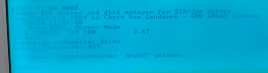

First test is successfull!
This is really amazing work. The pczip.com still fits on the 360 kB MS-DOS boot disk (with some other essential things), so I don't need a disk in B: for the GUEST files. And mostly the best thing is that it uses 90 kB less of RAM, so now I have 584 kB RAM free instead of 493 before.
Thanks a lot for this fine piece of programming!
I let it run now again DOOM8088 timedemo 3 to see if it works over longer time and if the more available memory may speedup the game a bit.

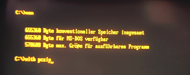

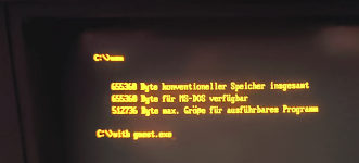

Another result, running pcZIP on Olivetti M21:
Here it is "only" 66 kB more free RAM. I can't explain the difference to the Olimarck result where it is about 90 kB difference but anyhow I am happy. Lateron I will try on my 2nd M21 which is having only an 8088.
@1ST1 We should dig in to the difference between the two. If you run "mem /d/p" and post the results, we can see the exact amount of ram taken by pcZIP in each system. However, under all conditions the driver should take about 6.9KB of RAM. It's almost hard coded in the driver that way, so there is not a lot to go wrong. If you are running with the /guest functionality, there is a DPB tacked onto the end of the driver for each drive letter used. But, each DPB is only ~32 bytes. Post mem /d/p from both guest.exe and pczip.com
Sol basically did not hat problems with the drivers until now. It seems to work good. Tested with MS-DOS 5. But not tested the enhanced things like fdisk yet.

1. Olivetti M21 Iomega Guest mem /d
  Adresse     Name         Größe      Art
  000000                   000400     Interrupt-Vektor
  000400                   000100     ROM-Übertragungsbereich
  000500                   000200     DOS-Übertragungsbereich
  000700      IBMBIO       000AE0     Systemdaten
                  CON                   System-Gerätetreiber
                  AUX                   System-Gerätetreiber
                  PRN                   System-Gerätetreiber
                  CLOCK$                System-Gerätetreiber
                  A: - D:               System-Gerätetreiber
                  COM1                  System-Gerätetreiber
                  LPT1                  System-Gerätetreiber
                  LPT2                  System-Gerätetreiber
                  LPT3                  System-Gerätetreiber
                  COM2                  System-Gerätetreiber
                  COM3                  System-Gerätetreiber
                  COM4                  System-Gerätetreiber
  0011E0      IBMDOS       00A480     Systemdaten
  00B660      IBMBIO       0031B0     Systemdaten
                SETVER     000190      DEVICE=
                  SETVERXX              Installierter Gerätetreiber
                           000380      FILES=
                           000100      FCBS=
                           002990      BUFFERS=
                           0001C0      LASTDRIVE=
  00E820      COMMAND      0012E0     Programm
  00FB10      IBMDOS       000040     -- Frei --
  00FB60      COMMAND      000100     Umgebung
  00FC70      MEM          000070     Umgebung
  00FCF0      DOSKEY       001030     Programm
  010D30      IBMDOS       000040     -- Frei --
  010D80      GUEST        000080     Umgebung
  010E10      GUEST        00A520     Programm
  01B340      IBMDOS       005BD0     -- Frei --
  020F20      ASPIPPM1     001BE0     Programm
  022B10      MEM          0176F0     Programm
  03A210      IBMDOS       065B50     -- Frei --
  09FD70      mKEYB        000280     Programm
    655360 Byte konventioneller Speicher insgesamt
    655360 Byte für MS-DOS verfügbar
    512592 Byte max. Größe für ausführbares Programm

3. Olivetti M21 pcZIP mem /d
                           000380      FILES=
                           000100      FCBS=
                           002990      BUFFERS=
                           0001C0      LASTDRIVE=
  010D30      IBMDOS       0000E0     -- Frei --
  010E20      PCZIP        001B00     Programm
  012930      MEM          0176F0     Programm
  02A030      IBMDOS       075D30     -- Frei --
    578608 Byte max. Größe für ausführbares Programm

Strange, the Olimark says it has extended memory... I need to verify that, but that is another topic. (no himem.sys driver or alternative installed/tested)
@1ST1 The extended memory being reported is probably via the INT 15h interface.
When looking at the dumps, PCZIP is always taking 1B00h bytes of memory in both machines.
In contrast, Guest loads the ASPIPPM2 module, in addition to itself. So, ASPIPPM2 and GUEST are both part of the Iomega GUEST program. By the nature of the way it is designed, GUEST can create memory holes which effectively reduce the maximum program size that can be loaded. This is denoted in both the M21 and Olimark.
Specifically on the M21, there is a memory hole being created in the memory map @1B340. This is denoted here in the IBMDOS line with 5BD0 bytes:

On the Olimark, there is a memory hole being created at @18900. It is slightly smaller because MEM's environment segment was placed at 18820. I'm not quite sure what KEYB2 is, but it is also taking a small amount of memory.

For PCZIP on M21. FILES= and BUFFERS= are larger

For pcZIP on the Olimark, The FILES= and BUFFERS= statements in config.sys are significantly smaller, yielding more available memory.

So, in summary, the GUEST program is creating a large memory hole fragementing the memory map. For PCZIP, the difference between the two is primarily with the amount of FILES and BUFFERS allocated in config.sys

The smallest driver seems to be the palmzip driver, but that is more unflexible than pczip driver.
I played with all of the above. Both ASPIDISK.SYS and PALMZIP don't manage disk changes well. PALMZIP always reports that the disk might have changed versus using the SCSI Request Sense command and as you noted only works with very old firmware ZIP 100 drives. ASPIDISK.SYS report write protected errors when there is no disk in the drive. It's also quite large. I wrote pcZIP for a reason. When I get some time, one of the updates to pcZIP will be to create an ASPI layer to main driver. It will probably be implemented with the /aspi switch versus the /lpt switch. Then there will be no reason to use ASPIDISK with Zip or Jaz SCSI drives.
For me aspidisk and disk change works fine. Maybe you have the wrong version from different EZSCSI version?
But anyhow, your driver is better. Thanks for your efforts.

I am also quite happy, but now I see two little problems:
1. when I start pczip /guest /lpt1: without having a zip drive attached (for example in autoexec.bat) then the driver still displays driveletter d: (pc has c: harddisk) without mounting a drive. In that situation it should display that the driver is not installed.
2. When running pczip /guest /lpt1: twice it will two drive letters for the same drive. That makes no sense and it might be dangerous, corrupting the file system when reading/writing alternated on both logical drive letters. pczip should check if the drive already has been mounted and cancel a 2nd mount.

@1ST1
The typewriter is amazing! The driver can run on DOS 3.2 or 4.01. Good work on getting a large drive attached.
1. The intended operation is to load a drive letter regardless of whether the physical drive is attached or not. This was one of my original criteria for the driver. I built a MS-DOS network boot disk where I load the driver and optionally use a drive on any system where I boot the disk. Quite a bit of effort was put into this feature, so you can just add any drive you want to the port when you want to access files. The driver will auto-recognize the drive, the disk in the drive and allow access. Just attach the drive, select the drive letter and press enter a few times. This allows you to access files on any drive / media you have without needing to reboot.
2. Yes, this was intended operation during development. It might be possible to perform the detection with the available information in the driver, however, there is a tricky caveat: When using a Jaz Traveler adapter, you can load the driver against multiple targets on the same LPT port. So, you could have a jaz traveler attached to a Jaz 2GB drive, and a ZIP 100 SCSI drive and then load the driver against each target. So, you would have to look at the actual drive the was on the port. However, the driver is designed to load when the drive is not present as described in 1. So, there will be cases when you simply can't make a determination. My inclination is to leave it alone.
