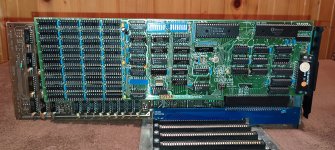

The passive backplane for the system and expansion cards; the original revision on the left has eight 2x43pin card edge connectors. All 8-bit ISA bus signals are present, but the pinout is different - the rest of the signals are either reserved or unused (such as power good, card select or memory size bits). Later revisions of the backplane were of the right-hand style. The basic computer configuration was shipped containing 4 system cards: CPU, RAM+RS232, video (CGA and later Hercules) and a floppy+LPT card. All of these are taller and longer than a full height PC ISA card, and so the ISA card adapters also act as "risers". Pictured above is a modern recreation from a far eastern PCB foundry.
I presume the reason why they did it like this was unreliability (for faster card switchovers) and avoiding complexity, instead of having it all on a single mainboard.

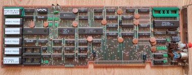

The "processor card". Actually, all of the system cards contain a wacky mix of AMD, Fairchild, ST and Siemens parts interleaved with COMECON counterfeits from the USSR, East Germany, Bulgaria, and of course our homebrew, the Czechoslovak Tesla. Back then they weren't making EVs...

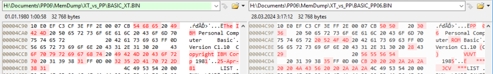

The card also contains eight 8K allocations for 2764 ROMs mapped between addresses F0000 to 100000, extra sockets were added by me. Both the BIOS and BASIC are shamelessly copied from the XT, with copyrights renamed and checksums patched to fit in the 8K chips. At the end, the BIOS date revision says S1/11/85 :)

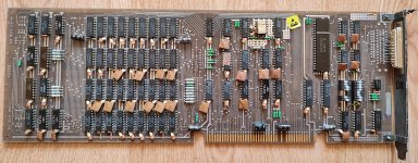

The RAM and serial port card. The earliest revisions were fitted with four banks of 64K, this one employs first two banks of Soviet 64K and the last two banks are West German Siemens 256K. All of them soldered in tight, no sockets, and no solder mask. Short circuits galore, just take a look at the bare serial connector wiring, that is original.
I made a lot of replacements on this board, especially of ceramic capacitors that cracked through, and Eastern Bloc tantalums replaced with regular aluminum electrolytics.

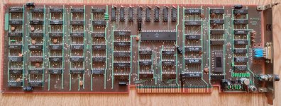

The Color/Graphics. Snowy and flickery, with Soviet DRAM and a Bulgarian SM607R (MC6845P counterfeit). RGB out through the DE-9, monochrome off the BNC. Preparations for a light pen kept in...

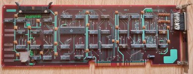

Floppy disk controller and parallel port card. A Bulgarian SM609R in place of the Intel 8272A, 74S188 mask ROM used for the read data separator bitmap. Wiring to the parallel port is insulated (hip hip) and we have a solder mask on card (hurray!)
Crème de la crème is the wrongly keyed floppy connector, with the arrow on pin 34. A "normal" cable with the small protrusion on top will be allowed to be connected in the wrong way only :)
