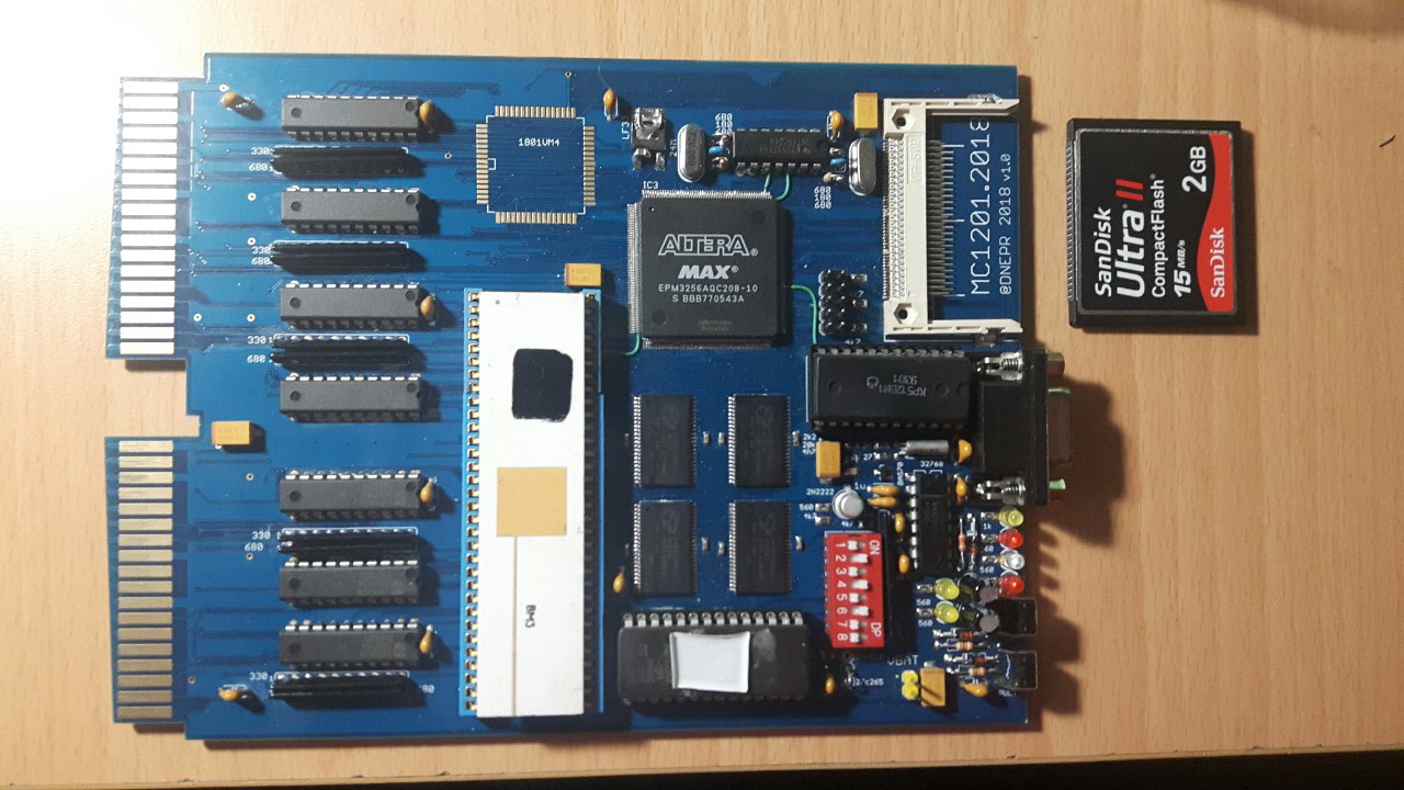

HC gives:
Unfortunately, this is not possible now - I don't make boards myself (and I don't even have the files for this), and I lost contact with my friend - he's from Ukraine.
Some of the capabilities of the first board.
