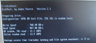

Performance wise hard to tell exactly, It boots fast enough, I ran disktest twice with ALLOW_INTS 0 in the BIOS.
And ALLOW_INTS 1 in the bios
MediaTest = PASS.
USB HUB does not work, The Flash drive must be the first / Only thing plugged in.
