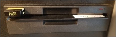

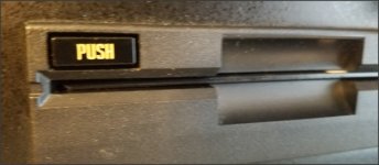

I have a Kaypro 2X - I am just getting familiar with it. Today I popped in a floppy, then attempted to eject it. I pushed the button in - it stayed in - and the floppy stayed in as well. I poked at the button several times with no result, then let it sit as I did other things. About 20 minutes later I hear a sharp sound, and lo and belhold, the disk had finally ejected. What's going on here? Is there something that needs fixing inside the floppy drive?

Drives that have been sitting for a long time tend to suffer from hardening of the grease/lubricant. I had to take mine out of the shell and carefully re-hydrate (don't actually use water!!!) with a little lightweight machine oil (sewing machine oil to us old guys). Then working the mechanism (with either the head-protector card or a junk diskette) to loosen it up. Be very careful not to get oil anywhere but on the eject/latch mechanism. micro-drops!!!
Yep i am familiar with those drives. The lube has turned to gum. They need to be taken out.. Cleaned and relubed.
