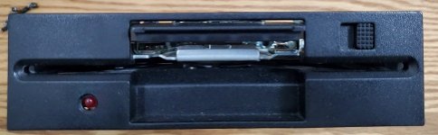

The drive is a Toshiba FDD 5406.
Front:

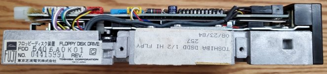

Model info:

I was inspecting the motor drive board (the one under the platter with the timing marks - see Bottom view) when I noticed that most of the electrolytic capacitors had corrosion on their leads.
I pulled the board, removed the capacitors, and replaced them with new ones and now the motor doesn't stall! Even better, it actually booted the Kaypro! Now I have a spare in case one of the others fails. This might be old news, but if you have a drive with a motor that doesn't spin under load, there might be an easy fix.
