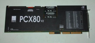

Not sure how to use it, not sure if it works.
Seems to be professional studio equipment.

As far as I can tell this is a pretty good card and intended for studio use. It has 8 balanced outputs and a possible 2 in, but I'm not sure if it needs the daughter boards to do the inputs. It has 18 bit resolution, >90db snr, and max 26dBu output so you can actually drive something with it unlike those dinky SoundBlaster thingies. :)

Yeah, it looked like some sort of studio equipment when I had briefly researched it in the past. Thanks for the additional info. I'm not really an audio junkie (don't get me wrong, I enjoy high quality music, but I'm no audiophile) and I also have no running ISA machines at the moment (at least none that can handle sound) so I have no need for this. Kind of a shame, I'd enjoy trying to tinker with it, but I have the opportunity to take as much as possible to the recycler in November so it's going if not taken.

Hm, I'm intrigued by this thing. It was apparently a $6500 card when it was new. It looks like it was marketed more at radio stations and other broadcast applications, rather than recording studios so much.
I still can't tell for sure if it's usable as a normal sound card, though. Those linked drivers seem to be aimed at interfacing with specialized software... I can't find any indication whether it follows any of the usual Windows standards, or if it will only work with the specialized software.
Still, I'm a bit tempted to take the gamble on it... it seems like a 50/50 chance, it'll either be an awesome sound card or completely useless.

Same conclusions I came to...which is why I won't punish you by making you pay anything more than shipping (shipping rounded up).
For what it's worth, I removed this from a Compaq dual P3 server a couple years ago.

Alright, I did a little more looking. Apparently that "np Runtime" is indeed a proprietary interface that only works with highly integrated broadcast software like Dalet and such.
I found an old discussion thread that mentioned a "wave driver", which allows the card to work with more standard software. I guess it works as some sort of an emulation layer on top of npRuntime, rather than a standalone driver. It was specifically being discussed in the context of Cool Edit Pro, but it should work with normal Windows audio playback as well. There is mention on the Digigram site on how to install the driver, however... I can't find an actual copy of it for download anywhere.
So, basically, there's a good chance that the card could be used as a normal Windows playback device for listening to your MP3s and such (on 8 different stereos at once, if you were so inclined), but it would involve tracking down an obscure driver... probably have to contact the company about it. It just seems like too much trouble for me, personally. If somebody else wants to take it and mess with it, though, maybe that info will be helpful.

So, basically, there's a good chance that the card could be used as a normal Windows playback device for listening to your MP3s and such (on 8 different stereos at once, if you were so inclined), . . .
That's 4 different stereos. There are 8 channels. The "balanced" is electrical the way audio folks do it to minimize noise. You can ground one leg though.
