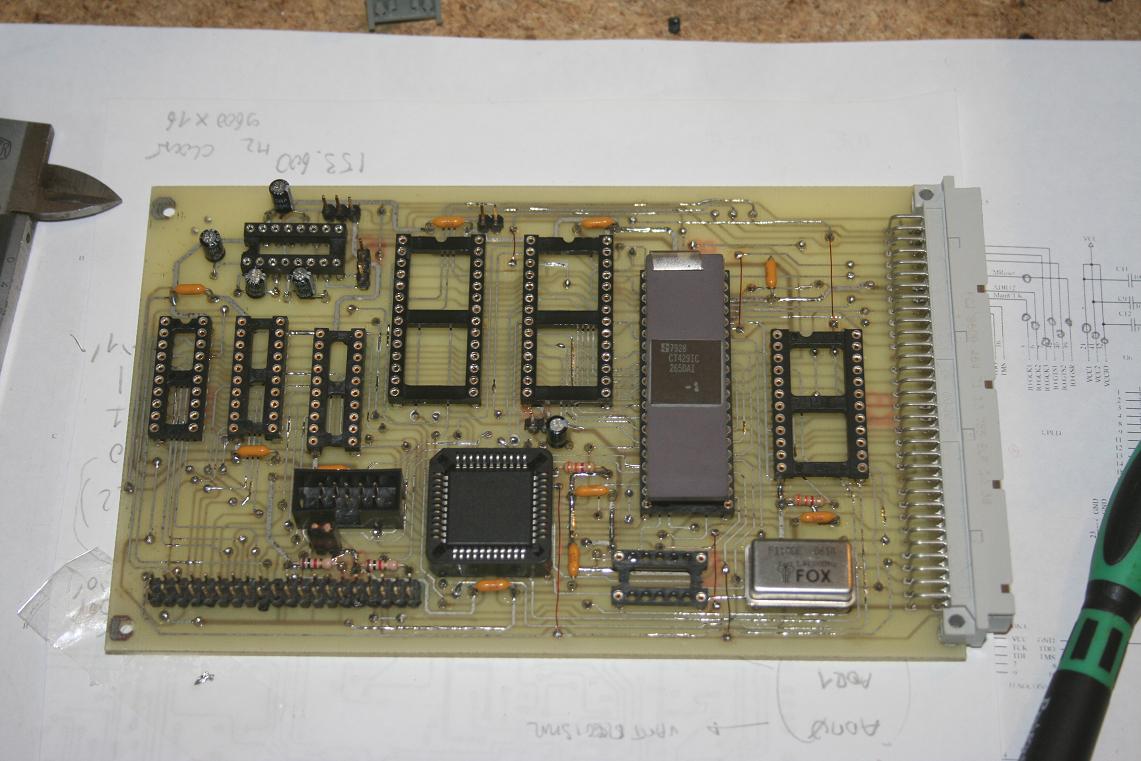

Hi guys,
as the title says : "Looking for a dump/source of MicroWorld BASIC Interpreter for the 2650".
Long time ago I made this system, I think I talked about it somewhere else can't find the reference :
Picture of the semi-finished board.
It contains a "bootloader" that allows to peek/poke/dump memory, a 6850 UART, 32K ram and an IDE interface I yet have to test.
It also has an XMODEM loader that allows you to load in some SW and run it.
I've seen the manual of this MicroWorld BASIC and seems quite cool but that's all about it, can't find a rom/dump/etc. anywhere.
I also happens I tried to make a certain dump of a certain FORTH I found can't remember where "almost working" but it had some strange problems, was crashing when trying to use stuff like : ..
Any pointers in any direction appreciated, would be nice to have that basic running again.
When I finished to write it, if anyone is interested, I can put a PDF here describing the board.

Ok I got in fact something, someone gave me a dump of that BASIC he made and maybe I should be able to make it work :)
Ok also "as soon as I'll be able to sort out the docs" ( and check it's all correct ) I will post a link/upload here a PDF ( made using the glorious LaTEX ) which describes in full the system "enough one should get inspiration and/or make a copy of it".
It's nothing "mega/special" but fundamentally is CPU + RAM + ROM + CPLD for logic + UART + a modified version of Phil's P.R.I.D.E interface.
Now little problem I can think of, I did use an XC9536 CPLD ( 5V ) I don't think they exists around any more, you could replace it with an XL9536/72 I think but you'd have to add a 3v3 volt regulator somewhere ( they still are TTL tollerant ).
One thing I could NOT work out was "if the 6850 ( UART ) needs CONSTANTLY the presence of E1 clock to work " ( I suppose so otherwise how could it serialize/deserialize stuff ? ) so with " a lucky trick " I managed to have it synchronized with the CPU clock, alas the 6850 goes 1 Mhz only when the CPU could go 1.25 Mhz but in this way they all go 1 Mhz.
It fits all in a standard 160x100 eurocard 3U.
Give me just a bit of time to sort out things and I'll post all here.
Ok just to let you know "the PDF is done" but I wish one person first to have a look at and give me an opinion before I post the link here :)
I hope it will be inspirational for other people here having that CPU and maybe willing to build something simple around it.
With that PDF and a bit of work and time you should be able to replicate ( modify, improve ) my small SBC and have fun with it :)
