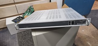

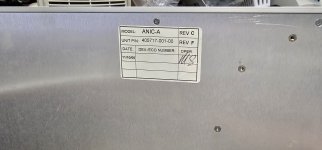

This really came out of left field today, but there is an old General Instruments ANIC-A for sale on eBay right now that seems to have some documentation... It is very expensive, but you might be able to haggle with them.

Hi Phil,
I came across your post while doing a Google search... I may have something you might be interested in:
I've got an old DEC 486 machine that has some General Instrument hardware in it, specifically this odd controller that was sitting in one of the 5.25" drive bays:
It's labelled "ANIC" by General Instrument.
It was connected to the system via a 50-pin SCSI cable to a BusLogic BT-542B SCSI card and it has 2 F-type coax connectors/cables coming out of it and going to one of the rear slot covers of the machine. The system itself (very heavy) is loaded with RAM, 3 SCSI Hard Drives, SCSI Tape drive and 1 out of 2 486-DX50 CPU's.
The machine hasn't been powered-on, so I couldn't tell you what software it's running, etc.
-Chris
I was never expecting to see that ...! I think you have one of the ACC access controllers - an early one. Possibly an ACC-2000 or 3000, but it's hard to tell without booting it up (and knowing the passwords)
The ANIC is an "Asynchronous Network Interface Controller". It connects the PC to the cable network so it can send commands to the headend equipment (scramblers and modulators) and cable boxes.
I thought it was an ISA card, I never expected it to be a full embedded 286 PC with SCSI. The Xilinx chip isn't too much of a surprise, GI used those in the MVP (video scrambler).
Would you be able to dump the contents of the hard drives, and the ROMs on the ANIC -- and maybe take some photos of the full system?
I can provide a Dropbox upload link if you need it.
If you're willing to part with it, I'd be interested in buying the GI-specific hardware and drives - but I suspect the whole machine might be too expensive to ship from Canada to the UK.
Feel free to drop me a PM or email (my forum username at gmail.com works, or see https://www.philpem.me.uk/contact ) if that's easier for you.
