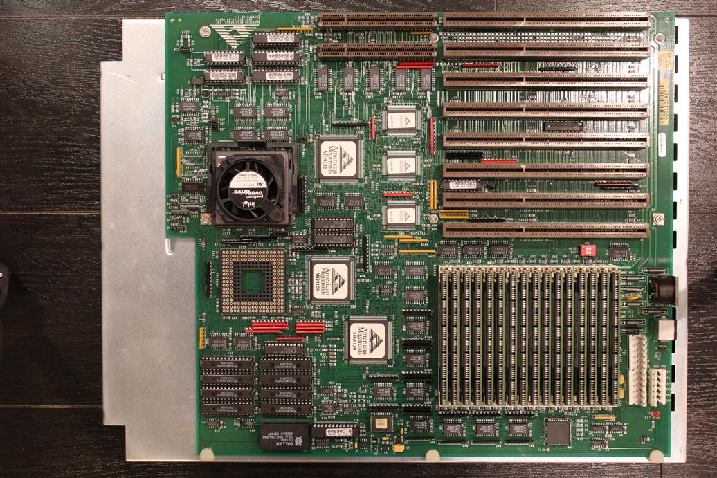

One of the things that caught my eye with this system was that fact that the sum of its parts was worth more than the system. The system was well equipped for the time and used brand name/high quality parts and equipment. It also came with a full complement of options as would be expected for a server of that time including an EISA SCSI Storage subsystem w/ cache and RAID functionality.
Of course the most important thing to me and what caught my eye initially was the motherboard:
The motherboard came out of the system with the original BIOS, a 80486DX2-66, and 16MB of 80ns Parity RAM. As expected this is a pretty big motherboard in terms of size. Components are nicely spaced and cleanly laid out. In fact the only thing I note as a negative is the soldered RTC. It would have been far better if AMI had spent an extra 50 cents to allow for coin battery backup or at least have socketed the chip. The board also lacks a header for an external battery. What this means is a future session of a soldering iron to either install a socket and/or a replacement DS1488 using a DS1485 and a coin cell battery. In the meant time the battery levels seem very good and are holding. This was also true for the Compaq RTC chip even though both systems are now almost 30 years old.
Also note the P3 connector (in addition to the usual AT P1 and P2 power connectors) behind the PSU connectors. I have yet to locates an AT class PSU that supplies P3. BTW: This should not be confuses with a very similar looking (but electrically different) aux power cable found on dual CPU AMD boards. That power cable provides both 3.3V and 5V power while the P3 connector on the Enterprise III needs three 5V lines and three ground lines (more on this later).

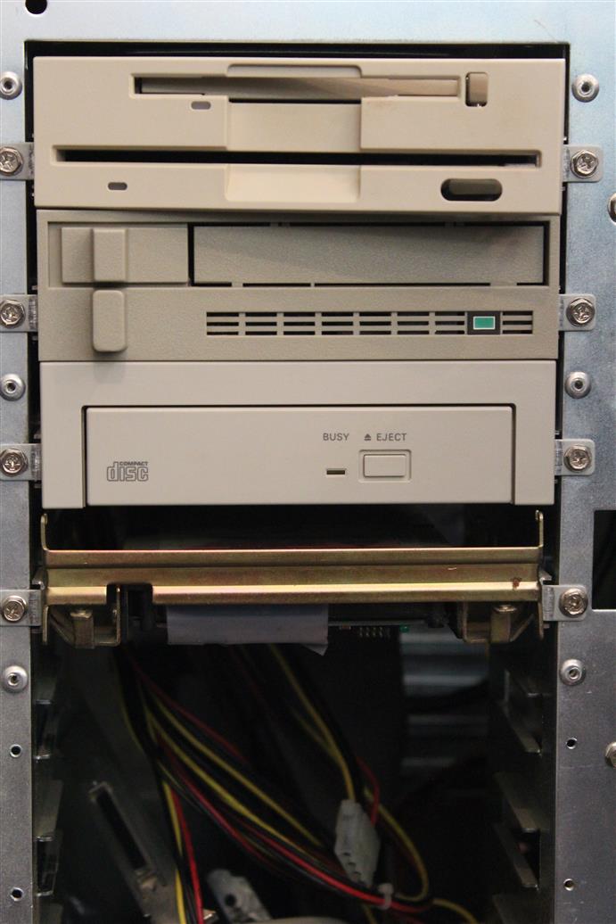

Next were the drives and storage subsystems. As already mentioned this was an all SCSI deal. While the transition to IDE had started it had not gained full traction yet. The typical home system could have easily been sporting an RLL drive controller.
From the top:
Teac FD-505 Dual Floppy Drive
Archive 2525S
Unfortunately the capstan has already gooified and will need replacement before this drive is put back in use.
MediaVision CDR-H93MV – This is a rebranded Ricoh SCSI drive. My guess? This was a later addition when the system left its server role became and everyday work horse. It was bundled with a MediaVision Pro Audio 16 with SCSI interface sound card (see below).
Maxtor MXT-540S – Unfortunately, I think mishandling and poor packaging killed this drive in transport. It started up the first few times but it was not happy – so it stopped starting up.

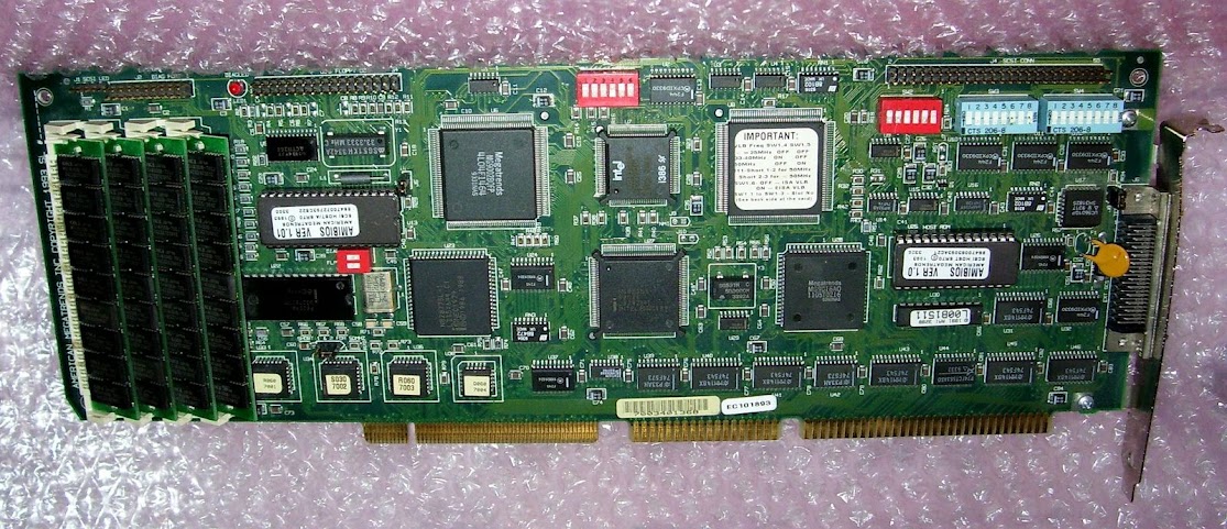

AMI Series-44 SCSI Controller - This was the second most interesting item in the system to me. This is a SCSI-2 Controller with an Intel 386SX-16 for processing. Originally it provide HDD controller and FDD support. The controller also sports 4MB of Cache which back then would have cost about $400 just for the SIMMs. This is significant in that in 1992 you could still buy a 386SX-16 system form the major clone makers as an entry system. So you basically had the equivalent of nicely equipped entry computer in this one controller.
Unfortunately, I have not found any real info on this card so I cannot determine if it had RAID support, if the memory could be expanded past 4MB, or any drivers for it. If anyone has info please get in touch with me!

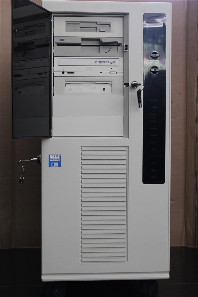

The first order of business was to paint all the equipment so that they could dry properly and cure. While the paint color came out very close to the original I am not happy with the actual quality of the paint I used. Even though I baked the side panels the paint is easily scratched. I foresee a future repainting, this time going all out with special primer and sealant.
Repairing the plastic windows was more challenging but I think it came out very nice afterwards. I first repaired the deep scratch with acrylic filler and then sanded it down smooth. Given the amount of damage to the window polishing it was out of the question so instead I opted for a frosted look by sandblasting it. A bit of elbow grease, a couple of plastic restoration techniques later and from afar it looks better then new.
Next I repaired all the wires that had torn off and since I had everything apart tried to do a better job of getting rid of slack and organizing the wires.
Finding the replacement camlocks proved much harder than I expected. However, I was able to replace both the simple camlock on the side panel and the e-switch on the front panel with parts that fit the OEM openings perfectly. Even the E-Switch function was retained so that it not only locks the drive window but also disconnects the KB.

The first thing to be updated was the motherboard. I started by flashing the BIOS with the only other version I could find. Going by the version numbers the "new" BIOS was released about three months later. There is no info with the file to indicate what bugs were quashed and if there were any new features added. As discussed earlier the term flashing on this motherboard might not be quite what most people are used to. Now a days when you want to flash a new BIOS you run a program, load the new BIOS and you are done. The program flashes the EEPROM and gives you a visual feedback of each step of the process. This can be even done through windows and the BIOS interface.
On the Enterprise III one must place the BIOS file on an empty floppy disk (no system files needed), open up the computer case to set a jumper, and then turn on the computer. The jumper tells the system to initiate a loader program instead of the normal BIOS routine. This program then reads the file off of the floppy drive and flashes the EEPROM. Your only indication that anything is happening is by listening to the beeping of the speaker. After the flash procedure is done you shutoff the computer, reset the jumper, and reboot. There is one huge benefit to this method: in the case of a bad flash you have a very good chance of recovery as you don't need a system that can boot or POST.
After upgrading the BIOS I proceeded to upgrade the memory. The Enterprise III can take a massive, for the time, 256MB of memory on board via 4 bank of SIMMs. So in went 16 of these beauties:
If you look at the boot screen in the information box only lists 64MB of RAM. However, there is a line under it that indicates there is another 192MB of extended memory.
The next upgrade was the CPU. I replaced the original 80486DX2-66 w/ a Pentium OverDrive 83Mhz. Now generally I am not fan of generational CPU upgrades (e.g. Orchid Tiny Turbo 286 or the Intel Inboard 386). While you do get a speed boost you miss out on updated bus (e.g. 16bit to 32bit), new memory architecture, and other tech improvements. However, in this case the OverDrive processor made sense:
  • AMI already provided the upgrade socket
  • The 83MHz OverDrive has an external bus speed of 33MHz so there should be no detrimental effects on the VL-Bus or other components with timing issues
  • 32KB of L1 cache which is four times the 486 L1 cache
  • A much improved FPU compared to the 486
And of course a Pentium VLB/EISA based system!
As you can see with the OverDrive chip installed the BIOS informational message changed. Interestingly it does not identify that a Pentium CPU is installed. Instead it reports an actually misleading informational line: "80486SX/SX-66MHz CPU"
My guess is that the BIOS core on the AMI Enterprise was simply too old to properly address such large memory and Pentium chips. The documentation for the motherboard talks about forthcoming OverDrive processors so the actual processors were not available for testing. If someone has a later BIOS revision I would love to test it out and see if they ironed out any of the cosmetic issues.

The SCSI controller looks an awful lot like the VLB AMI Fastdisk.
How well supported is the POD83 in this thing? Does it support L1 in WB mode? Is L2 enabled?
Is the DS1485 a drop in replacement for a DS1488? I have Nice SuperEISA that uses a DS1488 and don't really feel like drilling into it.
Yes, but the DS1485 is a SOIC part so you have to design a PCB ala the DS1887 replacements out there.
Ha! Any information or linkage to information on this? Drivers or manuals would be fantastic!
I am not sure on WB on L1. However, L2 is enabled.
Looks like DS1485 is available as both DIP and SOIC, however the DIP version is only 600mil, whereas the DS1488 is 740mil, so you'd still need an adapter for it....plus it also requires a crystal and battery. I'd definitely be interested in an adapter for the SOIC version though.
I don't have any special information pertaining to the EISA card, but I think I might have a copy of the manual for what I think is the VLB version (AMI FastDisk). I'll see if I can dig it up again. Judging by the components on this card, I'm somewhat confident it would work with the software from the VLB.
http://www.uncreativelabs.de/th99/c/A-B/20031.htm
I seem to recall the PDF manual I had was for both EISA and VLB versions. The main difference between the two is that the EISA version doesn't have the switch banks. Those are probably set using the ECU, so you really need the driver disks. I can't remember if I located those or not. AMI actually still has a lot of this stuff on their server, but for some reason it's almost impossible to access it directly from their site.
http://66.113.161.23/~mR_Slug/EISA/!AMI44C1.CFG
Supposedly these cards are buslogic compatible, so you might not even need the original drivers.
Good to know about the POD83. The Nice SuperEISA is somewhat of a clone of the AMI enterprise III/IV so it's likely POD83 would work okay on my board too.
Thanks for that info. The DS1485 is available as a DIP but if you want to fit everything in the same space as the original DS1488 you have to use the SOIC part.
I am not sure if this is the Fast Disk. It matches your picture nicely but the link on uncreativelabs is different.
I had the CFG file for the EISA card but it does not really do anything aside from auto assigning resources and telling you about the two switches (which are pretty self explanatory). If you find your copy of the PDF I would love a copy of it and any software you may have. I will check the Adaptec site and see what I can find as well.
TIA!
O.k. Thanks to AC's info I was able to find OS/2 drivers for the SCSI Controller. They can be DLed here.

I found the driver disks and "manual" for the series 44 controller. AMI apparently used WP5.1 to make the manuals (another tidbit of info I found during my searches). Hopefully, the files are intact. The PDF guide you linked to is for revision 2 of the board. There is a manual in three parts as well (s68man.exe is the archive). The first file seems to be corrupt. The other two will load in Word as WP5.1 files albeit with errors.

I think the files for the 44 series are in this file:
http://66.113.161.23/~mR_Slug/temp/SCSI.zip
Read Dsc_scsi006.txt and Dsc_scsi007.txt, then look at DISK1.ZIP etc. The dir is a mess no idea where disk 5 is.
