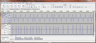

What am I doing that's silly? I mean besides playing with 8-bit computers in the middle of the night in the year 2014. :-)
I'm trying to convert programs gleaned from the internet into .WAV files so I can load them into my honest-to-goodness old-fashioned TI99/4A, i.e. not an emulator. Ultimately, I want to record them on actual tapes and load 'em up old school.
Things I know:
- My TI99 can SAVE a "Hello, World." program to tape, and OLD it back, successfully.
- The TI99 seems to use a form of Frequency Modulation, so within reasonable lower and upper limits volume is not all that critical. (This is opposite of the ZX81/Timex, in which tape speed is forgiving but the volume setting is key.)
- These guys have successfully used CS1er to write .WAV files from the FIAD program files, and loaded the audio files back to a TI99.
Things I don't know:
- Why I can't seem to do the same thing, with either CS1er or with Tape994a. The .WAV files I create all result in "Warning: Check Program in Memory ... I/O Error 50"
- Why the output of either program seems to be centered on zero amplitude, while a PC recording from my (working!) original tape seems to have a DC component and uni-directional amplitude.
- Why I don't go to bed like other people's children.
(Okay the last one is sort of moot.) Here's an illustration of the waveforms I'm getting. The top is a program I have yet to experience, as output by CS1er. The bottom is my "Hello, World." picked up from tape.
I have not managed to run my the TI99-to-TAPE-to-PC file back into the TI99. I think the volume as output from my sound card is not high enough, but at this point I'm not sure. I think I have tinnitus--I hear that dang sync file header even when nothing is playing anymore,...
Actually, the volume can be a real issue--and I/O Error 50 is usually the result of it being either too low or too high. This remembered from my days with an unexpanded TI back in the early 1980's. You might also want to check on the TI subforum over on AtariAge, http://atariage.com/forums/forum/119-ti-994a-programming/ as they had several discussion threads there on the trials and tribulations of cassette to .WAV files.
And now "I" have that annoying tinnitus thing, as the sounds of a cassette recorder starting to send a program to the TI starts impinging on my consciousness after a pause of 30+ years. . .LOLOL
Still can't get one of these .WAV files to load. Tapes made from the Ti99 load fine, but those written by CS1er or Tape994a cannot be loaded directly or via tape.
Apparently I'm not the only one. Found this comment here: "actually i have found CS1er does not really work. it will make an audio file, but when loaded into the ti99/4a it does says something about a error in data".
Yet others have had no problem at all, as in this one: "I tested a couple out with CS1er and my TI hooked directly to my PC's line out, and they loaded up nicely. There's just something oddly cool about that."
Mixed results it seems.
I even tried running the output thru a 4148 diode to carve off the negative half of the waveform. That also had the effect of diminishing the LINE OUT from my PC to a rather perfect attenuation for MIC input to my cassette recorder. I really thought I was on to something. Alas, still no joy from the tape. I may need a capacitor in there too.

Yup. The output from my PC sound is not quite high enough, and the TI times out saying there was no data. (My amplified speakers do not have a convenient headphone out jack to use.) The tape recorder's amplifier fixes that, and is NOT the source of any corruption, as noted above. I have had to make volume adjustments along the way to get things right, so yes it's important, but I think I'm over that part.

Yup. The output from my PC sound is not quite high enough..
Yes, I found this a common problem when I started to play around with loading WAVS through a soundcard into a computer. I found in both my laptop and main XP units, where the soundcircuitry came off the motherboard, just couldn't get the volume required. This was solved by dropping in a common old garden SB16 compatible card into a slot on the XP machine and disabling the on-motherboard sound.
Even with this, I found the volume needs to be just right for things to work. It can be so touchy with some of the machines that once I found a volume level that worked consistantly, I took a screen shot of the volume controls and stored the JPG in the same folder as the WAV files. I then referred to this image next time I revisited a machine and wanted to load a WAV.

Hi, new member here but an old-timer with the TI and a bit of an audio-buff. I've been thinking about trying almost the same stunt with my Timex TS-1000 to port a couple of cassette programs I wrote to emulation without manually re-entering all the code.
Most audio outputs from computers is adequate for headphones at best and only "line-level" in other cases. That's about the same as you'd expect from a hi-fi cassette deck to provide to a stereo amp or receiver.
Using the microphone input of your cassette recorder to "boost" the level was a good idea, but it's too much gain, the impedance coupling is all wrong and will it tend to distort. If you happen to have a stereo with a Tape or Aux input, you could try running your PC card output through that. I'd start with trying the headphone output as a feed to your TI. If you do try to connect directly to the stereo's amplifier speaker connections, make sure to start with the sound turned down and slowly increase it till you hear it in the TI's audio output to the TV you have connected to it.
Or if you have an Ipad or portable digital audio player, port the wav file over to it and try feeding its headphone output to the TI.

Here it is, 2023, and I've been struggling with playing back wav files to my TI-99 and ran across this thread. Cassettes worked just fine, but, until last night, all I was able to get on my TI was error 50 when trying to play wav's to it from the PC. I fiddled with sampling rates, outputs, the volume, and even tried recording to tape first, but nothing seemed to work.
I hate reviving a decade old thread, but I found the solution and just had to. I was reading the original TI manual and noticed it said to turn up the cassette deck tone control (i.e., more treble and less bass). It warned that if you didn't have tone control your volume may need to be louder. Well, I had already tried high volume, so I went into VLC, changed the EQ to the "Full Treble" preset and, voila, it started reading the data.
This stuff is of course fickle, and there can be a lot to diagnose with variable root causes, but I just wanted to get this one message out to all those trying to do this: Boost the treble, cut the bass!

Totally agreed about the treble / volume. I noticed that if I saved a basic program to my PC using audacity, I would have to turn the volume all the way up on the track control in audacity to successfully load it back in.
I also read that the ear and mic cables on the stock ti cable need to both be inserted. Something to do with ground for the signals I can’t remember what the reasoning was but I was recently trying to get a game (new basic cassette game Hells Halls) and wouldn’t work. Tried inserting mic cable and loading and bingo
That's exactly right - the ground loop is present in the TI-99 output line, therefore input won't work by itself.
