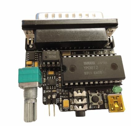

There's also the OPL2LPT and OPL3LPT, which is a Yamaha YM3812/YM-262. The YM3812 was used on the original Adlib, and gives you Adlib sound, but not Adlib compatibility. The original Adlib card sat on port 388h, while the OPLxLPT is on the parallel port, usually at 378h. This requires a TSR and a 386 CPU to intercept calls to the original port and redirect them to the parallel port. This unfortunately also means that protected mode applications can't use this method. There is a patcher available that can patch the executable of some games to look for the altered port for it to work.
The obvious problem with both of these solutions is they don't give you both FM and PCM synthesis, just one or the other, so you'll have to pick what you want. Theoretically with some black magic and two parallel ports, you could run both devices at the same time and have the best of both worlds. The black magic would be altering the TSRs and games to use the different parallel port addresses for the different sound devices. one would be at 378h and the other at 3BCh or 278h.
