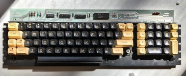

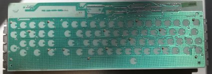

Keyboard is pretty beat and we did glue some broken bosses back in on the case. Mainly opened it up to make sure there wasn't anything metallic rolling around in there shorting the keyboard--we were hearing the broken plastic. We did this before first applying power.
