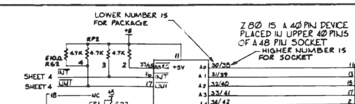

OK, Since you are not getting to the ROM's, and the CPU appears to be running amuck
you need to VERIFY the Control Signals that are inputs to the CPU's Pins:
Pin 16 - /INT
Pin 17 - /NMI
Pin 24 - /WAIT
Pin 25 - /BUSRQ
Pin 26 - /RESET
If none of these is being held LOW, then move to checking the Address Lines. The easiest
way to do this id to locate a known good SPARE Z80 CPU and make yourself a NOP Tester.
To do this bend Pins D{0..7} out enough so they will not go into the IC Socket on the Motherboard.
Then Solder a wire from D{0..7} to the GND pin on the CPU. Now insert the NOP TESTER Z80
into the Motherboard 40 Pin Z80 IC Socket, making 100% sure no D{0..7} Pin contacts the
40 Pin IC Socket on the Motherboard.
Power up the Computer and check A{0..15} across the Motherboard. You will have A0 being a
a square wave of some frequency. A1 will also be a square wave at 1/2 the frequency of A0.
A2 will be a square wave 1/2 the frequency of A1. Repeat for remaining Axx Lines. This will
check about 80% of the computer. What will remain is the Data Bus.
This assumes you have VERIFIED the +5 VDC Power Supply and the +12 VDC Power Supplies
along with checking for a Good Clock Signal from the OSC circuit.
Reference the attached PNG for the Z80.
Larry

I would swear I'd measured these before, but they seem to have been lost.
Pin 16 - 0VDC
Pin 17 - 5.12VDC
Pin 24 - 4.40VDC
Pin 25 - 5.04VDC
Pin 26 - 4.64VDC
Pin 6 - 2.04MHz
So obviously Pin 16 sitting low is an issue.

I pulled J8 from the board and powered on. Same garbage and 16 is still low.
Located both RP1 and RP2 and pulled the board and reflowed all 16 solder joints.
Pin 16 is now high, along with all the others. Still garbage on the screen though. No boot to M3 BASIC, etc.
