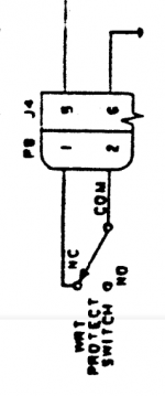

You better check the Floppy's Schematic for the differences in the Write Protect Switch and the Track 0 Switch. The Schematic I looked at
for a Tandon TM-100 Series shows the WP Switch and the TRK0 Switch as being a Switch with NO and NC contacts and they are wired
different. The NC and NO contacts refer to the Shelf state of the Contacts. If you pick up a Switch off the shelf, the NC contacts are CLOSED
and the NO contacts are OPEN. Operation of the switch changes the states of both sets of contacts.
It's possible you could have the logic state of the switches reversed, according to the attached schematics.
Larry

Both drives were cleaned already, that’s usually first step maintenance for old drives before I even try a disk in it.
I wired the switch correctly, they are identical so it was simple to get the contacts wired properly. What I saw agrees with the schematic picture you posted.

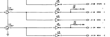

Interesting that Pin 18 isn't +5.0 VDC. Let's do more testing.
Assuming that you had removed Drive 0 (Lower Drive) Connector with Power OFF the Model 4 and
ONLY the Drive 1 Cable was attached to the Drive 1 Floppy when you did the Pin 18 test try this
test with Power OFF.
Unplug the Top Floppy Data Cable, and Plug the Lower Floppy Cable back on Drive 0. Now hold the
Break key depressed, and continue to keep it depressed while turning on the Power. When you see
characters on the display, release the Break key and tap the Enter key twice.
TEST #2
Put your Black meter lead on the Power Supply Common that powers the Floppy Drives. Now test the
Pins on the Top Edge Card Connector (Drive 1) and see if all the EVEN Pins are +5.0 VDC as the
previous attached Photo RS1.png. We are looking for Pins 18 and 20 to be +5.0 VDC.
What are your results? If Pin 18 is +.45 VDC (same as first test) then we need to look at the FDC's
PULLUP resistor R2 (150 OHM) tied to Pin 18 (Internal Connector).
TEST #3
With the Data cable disconnected from Drive 1 (Top Floppy Drive) Test Voltage on Edge Card of Floppy
for Pins 18 & 20. (should be 0 VDC) Use TP4 (COMMON - LOGICAL COMMON for the PCB).
Now check the Voltage on Pin 8 of U9 (Pin 18's LOW Voltage is on Pin 9) and Pin 8 of U9 should be +5.0 VDC.
Do the same test for Pin 10 of U9 (Pin 20's LOW Voltage is on Pin 11) and Pin 10 of U9 should be +5.0 VDC.
What do you get?
Insert a 1/8 Watt or 1/4 Watt 150 OHM resistor into RP1's Connector on Pin 1 and then the other end on Pin 2.
What do you get?
Larry

OK, I booted it into basic and this is the result-
Test 2 connector as follows:
18- 5
20- 5
Test 3 pins as follows:
2- 0
4- 0
6- 0
8- 0
10- 5
12- 5
14- 5
16- 0
18- 1.3
20- 1.3
22- 1.3
24- 1.2
26- 0
28- 0
30- 0
32- 5
34- 0
U9 pin 8- 5
U9 pin 10- 0
There's no way I'm going to be able to hold resistor legs into that connector without shorting something out, and I don't have a breakout board. Do the readings thus far tell you anything? Seems like some readings aren't what they should be.
OOPS, I skipped a step in the last part of the test.
Now check the Voltage on Pin 8 of U9 (Pin 18's HIGH Voltage is on Pin 9) and Pin 8 of U9 should be 0 VDC.
Move the end of the PULLUP resistor from Pin 2 to Pin 3. It is now associated the Signal on Pin 20 of the
Card Edge Connector.
Do the test for Pin 10 of U9 (Pin 20's HIGH Voltage is on Pin 11) and Pin 10 of U9 should be 0 VDC.
What do you get?
Larry
