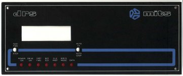

I received a MITS 88-DRS Board recently.
I can't figure out what's the purpose of this board used for. I can't find any information about this board on Internet, even in MITS official document.
This board is clearly S100 bus board for Altair 8800 system, and it could be a MITS prototype product that MITS never give it to market
Does anyone know about this board? Please tell me. Thanks.

It's the controller board for the MITS Altair DRS Digital Recorder System, which is also a mystery device. It was discussed at altaircomputerclub beginning with message #926.
Here's what I wrote about it back in 2006:
"Here's a question for all of the hardcore Altair experts out there: What was the MITS Altair DRS?
I never heard of it. I have never seen any advertisements or documentation, nor do I recall seeing anything in the old Byte, Kilobaud, or Computer Notes periodicals. The device is a mystery to me, and I would think that no such device ever existed if I didn't have an actual front panel in my posession.
It was obviously designed to use the same size enclosure as the Altair 680 computer (dimensions are 10.75" x 4.375"), and the LED legends indicate that it was definitely a mag tape storage unit. The artwork is in the 8800b style, so this was a late entry into the MITS product line. I suspect that it was never actually released, but the front panel is certainly not a one-off mockup, so there must have at least been quite a bit of internal documentation and perhaps some ad copy.
That's all I know about it. Is there anyone out there who can enlighten me? What kind of tape drive do you think was mounted in that cutout (3.0" x 0.875")? For that matter, what do you think "DRS" means? Digital Recorder System?"
There were several follow-up replies and some good guesses, but we never came up with a definitive description of the system, or even what "DRS" means for sure.
