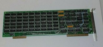

1ST1 this is the ATD model 16 memory card I have. Note the missing memory IC's and the 20 year battery is missing.

The ATD is not an original memory card from Olivett. Maybe not necessary. What kind of memory chips it has - 4164 or 41256?
Can you check which memory chips are on the long Olivetti memory card? (should be 4164 or 41256), then we know how much memory your machine finally has.
Have also a look on the M24 mainboard. It has memory as well.
All my M24 have 640 kB onboard, that is 18x 4164 and 18x 41256. Its not 16 times, but 18 times, because M24 has memory parity generator and check. Parity error can be hint to defect memory chip.
Older M24 have only 256 kB onboard, that is just 18x 4164. But as far as I remember, it should be expandable onboard, by adding 18x 41256 plus resetting the memory dip switches.
You can also try, if your M24 starts without extra memory in ISA, then it should come up with 128 kB. And then you can do memory test, with only onboard and with the Olivetti memory card. I sugest you to use the M24 customer test utility (see 6300 shrine and the the M24 website previously linked) and Checkit 3.0 (but this does not fit on one 360 kB disk, maybe better try Checkit 2.0), they both have good and reliable memory test tool inside. Olivetti customer test also should run on machine with only 128 kB total memory. So you can see if the error comes from base 128 kB, or from additional memory on memory card.
