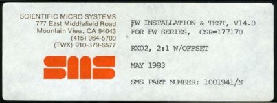

Due to the fact that you luckily got original software with yout SMS1000, I am wondering if you have a copy of this software. It might be also on your hard disk or together on an other diskette:
I recently acquired an SMS1000 model 40 and restored it, wich I documented here: https://forum.classic-computing.de/...0/&postID=336079&highlight=SMS1000#post336079
Now I am looking forward to reanimate an FWT117x device which has a Shugart interface and emulates DY devices. I have not started with it yet, and I don't know if the harddisk can be accessed without the enhanced DY driver, therefor I am asking.
