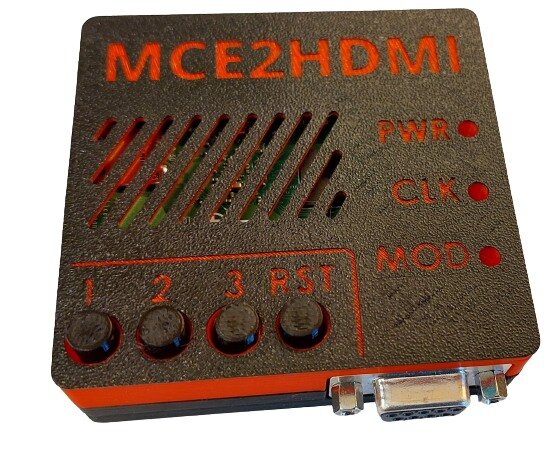

Since you are in Europe, have a look at MCE2HDMI
and another implementation for SCART
Does anyone have input/thoughts regarding this? I could just try it out as soon as my computer arrives, of course, but since it lacks both floppy drive and hard drive, I won't be able to fully test the graphics until I've bought proper peripherals.

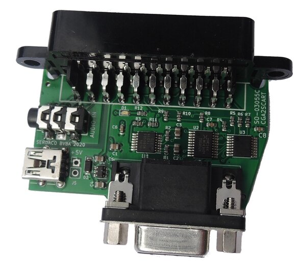

Could that device be used together with a SCART to VGA adapter (such as this one) to hook up my VGA monitor to the CGA card?
EDIT: This is the VGA monitor that I have, in case that makes any difference:
It looks like it will work, it's an active converter. In practice no one knows with these adapters, or what kind of picture you'll get.
Again, there is a better solution that is confirmed to work well. But I understand that the price might be deterrent.
Fair enough. Is the CGA2SCART PRO developer, Retro Erik, active on these forums?
