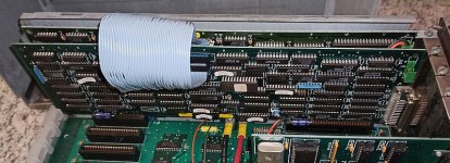

The FTP link does not work. How does it look like this DEB?
I have an Olivetti M24 with color monitor, but this is not with DEB I suppose?
deb.jpg - Click image for larger version  Name:	deb.jpg Views:	0 Size:	118.7 KB ID:	1210780
YESSSSSSS !!! Tschaka!
Do you know how to replace the graphics driver in Windows 1.0x? I don't want to reinstall, just swap the video driver to enhance from 640x400 1 to 16 colors...
