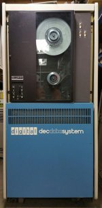

Found this pdp-11/34 decdatasystem buried in the back of a recently acquired collection.
I initially thought I only had the TU10W and RK07 drives. But once I figured out how to open the lower front panel (thanks Luigi) I discovered there was an entire 11/34 chassis down there - complete with programmers panel and controllers for the RK07 (RK611) and TU10W.
All looks to be in good condition. I'm looking forward to getting this running one of these days.
Does anyone have experience in restoring a TU10W tape drive? I'd be interested in any few pointers for things to watch out for.
Here's a link to some more information about it -> http://avitech.com.au/?page_id=903
The original differential vacuum switches that Al mentioned were probably made by Fairchild. World magnetics, http://www.designflexswitches.com/, bought the manufacturing rights from Fairchild, and still makes the switches. I use their switches for a TU45 restoration. Some of the World Magnetics switches are available from Digikey.
Take a picture of the boards installed in the 11/34, and post an inventory of the board part numbers. The part numbers are on the handles, or on the metal stiffener on the top of the boards. We can then give you some more advice about bring up the system for the first time.

I would remove the backplane jumper between the processor backplane and the RK611 backplane. Then move the M9302 UNIBUS Terminator to the processor backplane slot where the backplane jumper was removed. That would make the system a little simpler for debugging.
