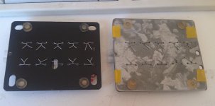

Here are the 5V and 12V PDP-11 dummy loads I built, I just copied Malcolm Macleod's ones he made for loading his 11/23 from his very useful website (original page, can't find the latest link to it):
https://web.archive.org/web/20160227030057/http://avitech.com.au/pdp-11-03/ba11nc/ba11nc.html
Mine have the ceramic resistors tie-wired down to a 3mm (1/8") metal plate for heat dissipation. The connectors are mains wiring 'chocolate block' terminal strips. Urethane feet keep the tie wiring from scratching surfaces.
I've put an indicator LED on the 5V load, haven't got around for one on the 12V yet.
