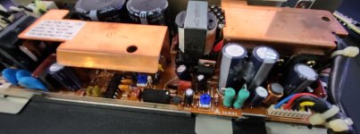

I'm the proud new owner of a Toshiba T5100! I received it yesterday. I've built many computers over the years but never had to fix anything this old. So far I have disassembled the entire thing and everything looks incredibly good except this corroded area on the board. Minus some dust etc on exposed areas. Even the hinges work pretty good!
My question is, would this keep everything from working? I get power and fan, and some weird droning beep like sounds that repeat. Didn't match any beep codes in the manual that I found. Anyway, thank you guys for creating a place like this and for all you do! This is amazing! If you need anymore pictures or information let me know.

Oh, also when I turn the power off I can see the orange plasma flash slightly. Not sure if that helps at all.
Is that corrosion or possibly glue to hold that (poorly soldered) connection/revision together?
That I'm not sure of. When I took the machine apart it didn't have any signs that I could see of it being opened before. Do you know if they did glue connections like that from the factory? I'm worried if I clean it and it's supposed to be there it might mess things up more so than they already are.
That's definitely not glue, it's corrosion. You can even see the corroded bodge wire.
All of that corrosion needs to be cleaned up, and those chips might need to be replaced if the corrosion shorted them out. The strange beeps are probably a sign that the motherboard isn't booting properly. A whole menagerie of different problems could be the reason it isn't booting properly, I'd start with cleaning that area of the board and looking for damaged traces and disconnected pins. You may have to replace those three ICs on the board.
You'll also want to check the VIA going through the board there, that looks like a pretty large trace, and it's likely a main power rail, hence the large amount of corrosion.
Thank you very much for the help. Much appreciated! I'll get it all cleaned up over the next few days. Any suggestions on what's best for a cleaning solution for older boards? Thanks again!
I use CRC Lectra Clean. It's expensive, but you only need tiny amounts of it at a time, a whole can will last you years.
It works a LOT better than isopropyl alcohol, which tends to just smear stuff around and is a pain to clean with. The only warning with Lectra clean is do not get it on plastic or an LCD screen, it will immediately melt it and cause irreversible damage. I accidentally sprayed one of my Xbox 360 cases with it and now it has what looks like white spatter marks all over it lol.
Another thing to note - Toshiba laptops from this whole era are notorious for bad capacitors in the DC/power supply boards. Usually they used ELNA caps which leak an absolutely nasty corrosive liquid to a horrible extent. So have a look at that, it may not be immediately visible. Photos off the entire motherboard and the PSU board would be useful to see as well.

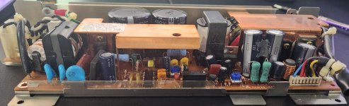

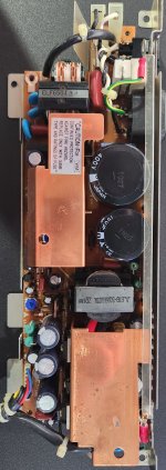

Here's a better shot of the motherboard. Thank you for helping! Very much appreciated! I'm a bit worried I won't be able to put it back together 😆
EDIT: Might have been the size from my phone. I cropped them and exported them to be smaller. Sorry about that

Images showing now. Luckily I see no signs of ELNA brand capacitors that leak so often. It's still probably a good idea to recap that PSU, it's just old enough that it could benefit, even if it isn't super likely to be your issue. Test voltage output from it if possible though. Don't think I can help with your issue though unfortunately.
Also, pull that Tadiran clock battery from the board. Those can leak catastrophically. Not as often as NiCad Varta batteries on many other systems, but when they do spill, it's bad bad news.
