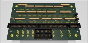

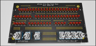

There is now an updated QProbe 2023 that adds disk drive activity to the display panel. I
Guys,
FYI: as Mark told, the new drive LEDs can be driven by both the BA23 panel connector and QBone simultaneously.
The BA23 20pin panel cable is routed throught the QProbe LED panel.
So if you like, you can wire up a BA23-QBone-QProbe combo.
And as Mark is happy now, I declare the endless prototyping phase as completed ;-)
Joerg

Guys,
Joerg

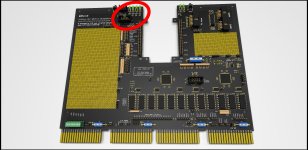

Since I have 3 of the first QBones, will there be something to tell how to add the drive light capability to the older versions?
You need to solder a 2x5 IDC connector to the prototyping area. and connect it with 5 wires to GND and existing LEDs. See J10 in the schematic.

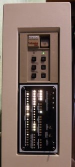

I finally finished the build and installation of my QProbe 2023 into my BA23 housed 11/83. Despite thinking I had been careful when installing the reset momentary switch, I managed to install it reversed and had to haul it out again to fix that. To help hold the LED panel sled in position, I drilled a hole in the sled to accept a button (Fillister) head screw to be trapped by the spring clip. It's fun to see the BSD 2.11 idle pattern rolling along the lights.
Congrats on your build of the QProbe 2023. I’ve only run RSX11M+ on my 11/83 so that’s the only idle pattern I’ve seen so far, but it’s good to know that BSD 2.11 also dis its idle pattern on QProbe 2023. I‘ll have to boot that from the QBone some time and see it.

Nice video. I am curious about your 11/83 system. To see the RSX11M idle pattern on an 11/83 you have to basically disable PMI access to memory by putting the CPU above memory in the backplane. Also, your CPU must have cache. This leaves the idle pattern on the Q22 bus when RSX hits the wait instruction in the idle loop. I wondered if BSD 2.11 behaved differently.
While I was writing this I also got to wondering whether the 11/83 CPU could use a combination of PMI and Q22 memory. In other words what happens when the CPU is between two PMI memory boards? Part of memory is faster and the other part is slower?
My 11/83 only has 3 MiB of Qbus memory unfortunately, I had an 11/73 M8192 CPU card in there originally and was lucky to get one of those NOS 11/83 CPU cards a while back and had an 18 MHz capable J11 chip to put into it. Everything I've read suggests it is possible to use both PMI and Qbus memory cards in the same system with the Qbus memory accesses being slower than the PMI ones.
