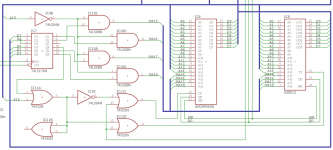

Maybe it helps if I give you the schematic of my design:
The 174 latch serves as Memory Management Unit (MMU) selecting chunks of 32KB of RAM or ROM for the first 32 KB of the address range. When the range 8000..0FFFFH is chosen, RAM is always selected and always the same RAM (common area). In this case the very first 32 KB of the 62816. After a reset the first 32 KB of the 29F040 is selected in visible in the range 0000..7FFFh. So the Z80 has ROM available to start up from. It is not that I need it, it is just available due to its design.
After the ROM has copied what ever is needed from itself to the common area and the Z80 started to run from there, it is a matter of writing the correct value to the 174 latch to fill the first 32 KB of the range with RAM. Writing 41h to the 174 will select the second 32 KB block of the 62816. The 29F040 can serve as ROM drive. For example, writing 01h to the 174 will select the second 32 KB block of the EEPROM into the 0000..7FFFh range.
So my choice for going for a 32 KB ROM is not that I need it so big but it fits in the whole design. But if there is something wrong in doing it in this way I would like to know, please.
The remark on just having an 8 KB common area triggered me to create another design. Expanding the above design with extra MAxx address lines won't work so created one using a 74LS612 MMU, The MMU enables me to pick any chunk of 8 KB of RAM or ROM for any 8 KB in the range for the Z80. If anyone is interested, let me know.
Yes, a schematic helps a lot.
So, if I understand the intent of your design, you have a "bank" register where bits 0-3 select a 32K "bank", and bit 4 selects ROM ("0") or RAM ("1") in address range 0000-7FFF. Address range 8000-FFFF is intended to always select RAM address range 8000-FFFF. It would appear that you allow banked access to ROM as well as RAM, depending on D4, which I presume is to facilitate in-circuit flashing of the ROM as well as allowing access to all code in the ROM (provided the ROM code is organized into 32K banks).
NOTE: I'm not sure if that RAM/ROM select circuit is correct, it might be reversed/inverted. You may want to double-check that.
So, I think you can make this work for CP/M 3, you just have a somewhat-restricted bank size so the amount of code and buffers you can place in bank 0 is limited.

You understood the schematic all right. The reason for choosing a 8KB bank size and not 4 KB as was possible, has to do with the number of OUT instructions that have to be performed. 8 KB means I only need seven.
I never ever hear about "read bank" or "write bank". I'm 100% sure that the C128 and Bondwell 14 cannot do that and these are the only machines I'm familiar with.
As an aside, I believe you could adapt the 74LS612 to support XMOVE by feeding /WR to one of the MA inputs, and programming the bank registers accordingly.
First, I haven't heard of XMOVE or LDIR either but I guess what XMOVE does. I know what you mean but I cannot translate it into a schematic so quickly. But it led to my own solution of using two 74LS612s: one for reading, the other for writing. Simple IMHO :)

But I gave it a good thought and I decided to go for the MMU design instead. Just because it is more flexible. Have a look at the schematic:
As you see, just a few parts. The flip-flop made out of the two 3-input NAND gates makes sure that the MMU starts up in "Pass mode". If you want to know more, let me know. Just one thing: not a single bit of software has been written yet. I first have to revive all very old knowledge I have of CP/M, or better, what should come in the ROM and how should the first files look like.

Here is a dirty hack of the previous SCH, now having two MMUs:
Main differences: the extra MMU of course and I had to add a 139 2-to-4 demultiplexer. The MAxx outputs are activated by the ME input. The idea is simple: one output is activated by the WR signal, the other by the RD signal. If you see any flaws, please shoot.
This won't be the final version. The idea is to replace the two 139s and the NAND IC with one GAL. It seems a 16V8 will do but I'm only human and could have overlooked something.
