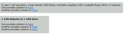

  • It seems to have the default Floppy controller card from IBM. If I were to upgrade the BIOS, would that prevent me from using higher density drives?

The stock floppy controller does not support HD floppies, but there are options available to replace the controller with one that does, some upgrades bring their own BIOS to support HD floppies and drives.
Per the following at [here].
A warning. A 1986 dated IBM 5160 motherboard BIOS may prevent booting from a 1.44M diskette in a 1.44M drive. See [here].
Thanks again. the floppy stuff isn't too big a deal for me currently, it would just make it easier to transfer things off of the HDD while waiting for things like the XTIDE to be delivered.
