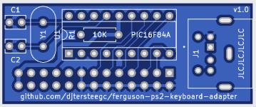

As part of a recent estate sale, my son and I ended up with two Big Boards, one built, and the other almost completely bare. Stripped the bare one down, took a couple of scans on a large format flatbed and started doodling in Sprint Layout. Doesn't look to bad to replicate if anyone is interested in also rebuilding one of these on a new PCB. Couple of choices I foresee are
1. Uses 250 mil (6.35mm) spacing for all the decoupling caps. Tempted to reduce that to the more commonly available 5mm ceramic discs you find today.
2. Couple of traces are at a non 45 degree angles, so the layout will need to deviate a bit there.
3. Can't recreate the 45 degree crosshatching in Sprint for the ground planes. Should you even really be crosshatching these days?
4. The Chinese PCB fab blue soldermask I've got in the past is darker than the original Ferguson boards. Interestingly the built one that was exposed to the elements has changed color from blue to almost green.
5. Should I work things like the 4Mhz mode and other "improvements" into the design, or leave that to rework after the fact? I'm leaning towards keeping it original. The built one I have is a mess of rework wires and quite frankly I'm not sure what some of them are attempting to do.
Probably work on this over the next month or so. The built board looks really bad (stored in the corner of a garage), and I'm not sure I want to build the NOS one, so this seems like a fun way to get one of these up and running and build some new skills for replicating old PCB's.

Spent some quality time with Sprint Layout last weekend and I'm close to sending off the first batch to JLC to be fabbed. Ended up sticking with a faithful reproduction of the the original work (including hand drawing the prominent cross hatching and tracing the custom Ferguson font, ughhh) but did correct the wrong silkscreen on U52 (16 pin DIP socket, supposed to be a 14 pin) and added a couple missing component references to make building these a bit easier.
Overall Sprint Layout performed well for this task but could really use a couple key features. Just for fun I tried the new bitmap function in KiCad 7 but it was clunky compared to Sprint in the task of tracing an existing board.
Once I get one of these built and tested I'll let people know how they can get a board of their own if desired, so still a good month+ out on that front.

To clarify, this is the original Big Board from 1980, not the Big Board II released in 1982. Glad to see you been able to recreate the two custom PAL (GAL?) chips. That was an open question recently in another forum about the feasibly of building a II from scratch given those "proprietary IC's".
Everything on the original Big Board is off the shelf and can still be sourced from places like eBay or UTSource. Two EPROM's, but those dumps are also readily available to be recreated as needed.
Boards are at JLCPCB currently. Project got back burnered due to summer hobbies (Minnesota, gotta make the best of it before winter is back), but with VCF Midwest coming up, figured it was time to at least try version 1.0 and see how well I did with the layout. Hopefully I can get one built and tested before the show, otherwise I will have some extra boards for cheap there with the caveat you may need a bodge wire or two. Since I fixed two factory bodges with this layout, I figure I'm afforded at least two myself. :)
Also created a PS/2 to parallel keyboard adapter PCB that should plug right into the Big Board based on the work shared here, https://forum.vcfed.org/index.php?threads/ferguson-big-board-1-monitor-rom.32705/#post-405189
