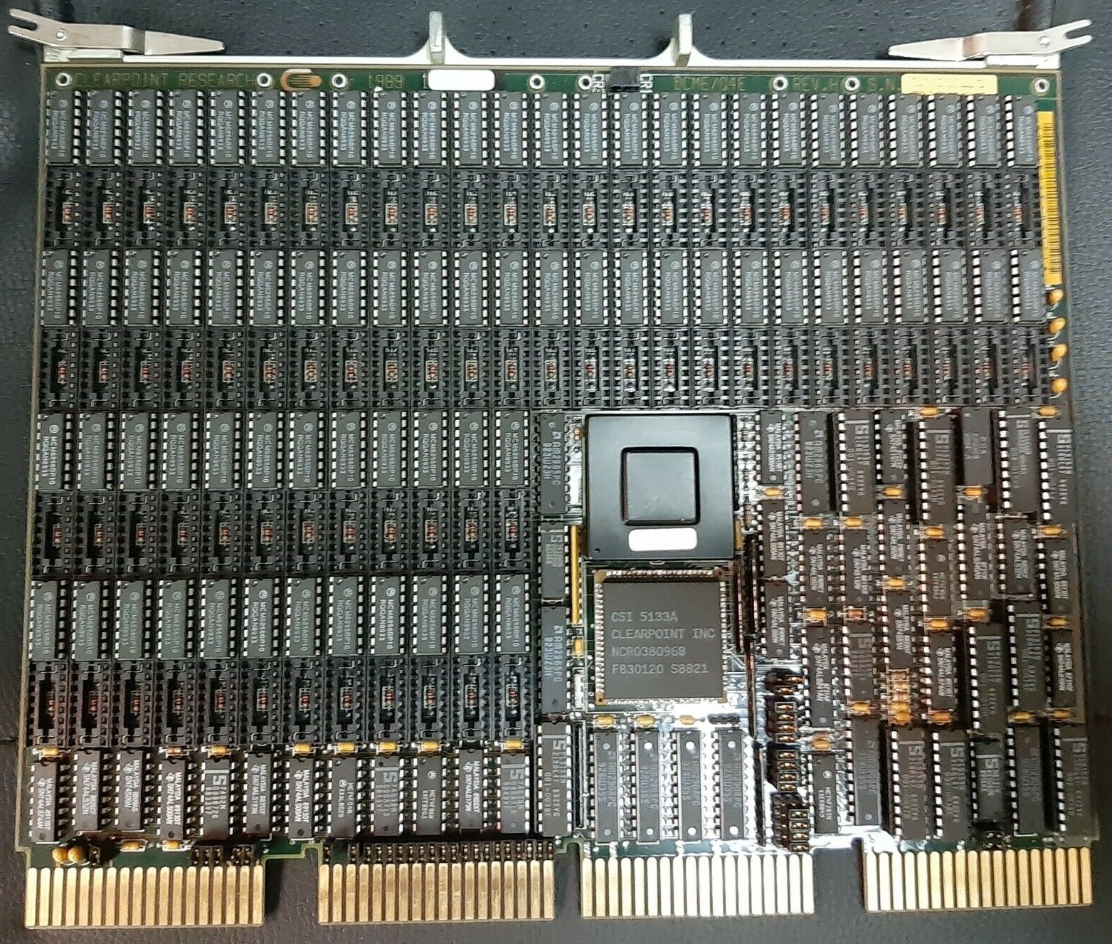

Well, this is interesting. Bought a Clearpoint 4mb PMI memory board on Ebay from a reputable seller. Got the card, plugged it in, didn't work. Changed one jumper that appeared to be the +5 battery/+5 line, and the card came up. Probably was used in a pdp11 with battery backup memory.
Anyway, the card worked well, passed all diagnostics, however it was only coming up as a normal Q Bus memory card.
Checking around I found a picture of another users' memory board, he had additional jumpers on the C/D jumpers, mine did not. That's not a good sign: If a PMI card is plugged into a normal Q bus slot that will usually blow out the board. But I ordered a set of jumpers, put them in, and now I get this with the board in slot 1, CPU slot 2 (CPU PMI works, I have a 1mb PMI board for testing):

One thing that is interesting: The board has a total of 148 256k chips. Which makes no sense as a parity board should have 144 chips (18 bits * 8 banks of memory). So what are the extra 4 chips for?

Test 1: See if those last 4 chips are bad?
Pulled the last chip from the board (all chips socketed, thank you Clearpoint!)
Run board in Q Bus mode.
Results:
Board comes up. Yellow light in center is on.
Board passes boot diagnostics as 4mb memory.

This morning before work I tried removing another chip, bottom row, one to the left of the last chip. This caused the board to fail in Q bus mode with memory errors, so it looks like I hit a low memory bank. Put that chip in and took out the chip above the first one. This time it came up failing the CSR test, but the memory itself did pass diagnostics.
I think I see a pattern. Possible the last column of chips at the bottom of the board are the four used for board housekeeping. I'm going to try replacing them with 150ns 256k memory chips (all I have) and see what's up.

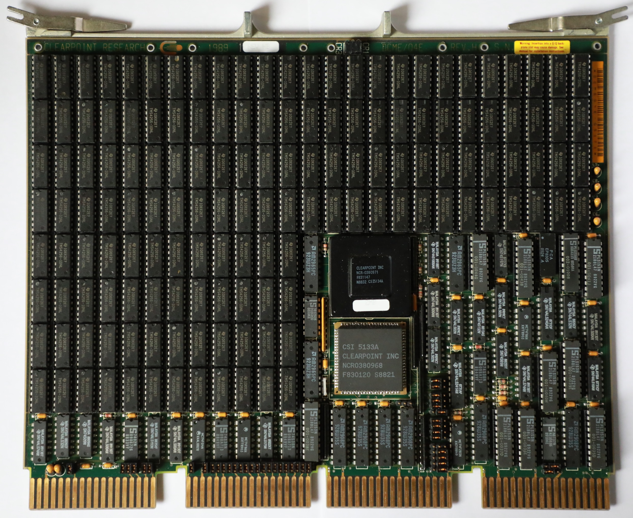

Fortunately - there was a photo - http://www.kpxx.ru/dec/PDP-11/Hardware/DCME-Q4E-F/ClearPoint DCME-Q4E-F-Front-before.jpg
Fully filled with memory chips - http://www.kpxx.ru/dec/PDP-11/Hardware/DCME-Q4E-F/ClearPoint DCME-Q4E-F-Front.JPG
But you still need to set the jumpers - the top four (размер памяти в Мб) determine the size of the memory - http://www.kpxx.ru/dec/PDP-11/Hardware/DCME-Q4E-F/ClearPoint DCME-Q4E-F-switches.JPG

Pulled every chip in the first 2 megabytes (based on Hunta's picture) and tested them in my Pro/350 by plugging them 16 at a time into the Pro memory board and running the power up diagnostics.
All pass, which means the problem is in the ASIC or the PLA's. I guess someone plugged it into a Q/Q slot with the jumpers in, then removed the jumpers so it works.
