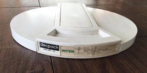

A few months ago I picked up an RK05j for my PDP-8/e, and I've finally got around to replacing the foam and testing the electronics, which so far seem fine.
However when trying to load a cartridge, it doesn't seem to stick to the spindle magnet correctly, as the platter hits the "duckbill" when the spindle is rotated.
Click image for larger version  Name:	Platter Wobble.gif Views:	0 Size:	9.3 KB ID:	1230660
At first I suspected that the spindle could be bent or that the disk is warped, but no matter what rotational position the spindle or platter is in when a disk is inserted, the platter hits the duckbill whenever the spindle is rotated about 90° in one direction and 100° in the other. I've checked the spindle with a dial indicator, and there's no discernible movement. Whenever the disk is inserted, a small gap is visible between the spindle and base of the disk (mating ring? I'm not sure if there's a term for it), which gradually closes as the spindle is rotated, at which point it bites against the duckbill.
Does anyone have any idea what the likely cause is and how to go about checking it? At this point I'm suspecting there's either a problem with the cartridge receiver (nothing stands out as being wrong though), or the alignment of the spindle shaft perpendicular to the heads.

I've had a few packs that have that wobble problem. I haven't exactly figured what the problem was so don't take this as gospel. Originally I though it was damaged packs but got a good pack that showed it also. My guess is that the conical point in the center of the spindle is bottoming in the pack and preventing the pack from fully seating on the spindle. If the disk is sitting on the point the magnetic base will tend to pull it down with one side against the magnet and the other up. Yours is worse than any I have seen so could be different. I didn't think it was the cartridge holding the pack crooked since that would make noises if the pack was rubbing against it. Assume its some sort of tolerance on the spindle/pack.

That's certainly an interesting thought! My cartridge is a Scotch 910-16 rather than one of the official DEC ones (though they could have both been made by the same company for all I know).
I think I'll leave it alone until I can find a DEC branded cartridge and see if it fits. If it does I'll measure the spindle holes on them both.

I envy that suitcase! I have a stack of these disk packs as well, the non DEC packs seem to have problems to open the lid in the drive sometimes. And when you push too hard you can damage/bend the opening lever in the disk drive. (I hope anyone understands my explanation) The early RK05 drives have a lower force to push the pack on the seating. I have had disks which made a scratching sound. When I pushed a little on the pack the sound disappeared. So I replaced the springs which are pulling the pack down with stronger springs. (That complete pack holding system is modified in the RK05J drives)

If it turns out that the early drives need a genuine DEC Pack then I do have some. I am reluctant to risk this pack as it contains some useful diagnostics software 20586D81-2901-4A7C-B4AB-DE24BADBA8BC.jpeg

With thanks to SteveG I now have the Scotch pack pictured above to play with!
It mounts and spins just fine, but on inspecting the platter I found a few dozen odd specs and bumps (corrosion?) that can't be removed with IPA and Kimwipes, so I won't be able to test the heads just yet.
Meanwhile I completely disassembled my original pack, so I could try mounting the hub on the spindle without the rest of the cartridge getting in the way. It still mounts on the spindle at a slight angle, but will stay flat if pushed down hard. Yesterday I took both packs to a local CNC shop so they can compare the two spindle holes with a laser scanner. (They'll also scan the whole hub casting, for a potential future project.) If the hole is smaller on my pack, they'll mill it out. Hopefully then it'll still work when I put i back together.
This is what the hub looks like, for anyone curious.
