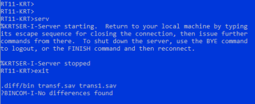

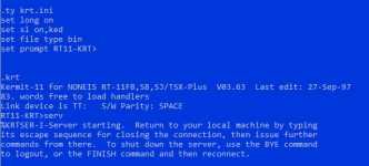

Here's how I am doing binary transfers from Windows to RT-11 with Kermit...
So I am using k95.exe - Kermit95 with this in the k95.ini file from Windows 10:
set line 2
set carrier-watch off
set serial 8n1
robust
I connect to the RT-11 host - here you can see the settings:
Alt-X returns kermit to local control, then for example type "get transf.sav":
When you press <CR> you get the file transfer progress:
Likewise for "send trans1.sav"
(I renamed transf.sav to trans1.sav on the windows box)
type "fin" to end server mode on the remote host and c to connect back to it and then exit to get back to RT-11:
For TSX, there is KRTTSX.SAV with works in the same way, but you can do more clever things in the KRTTSX.INI file...
This seems to work OK, but I welcome coments and suggestions..
