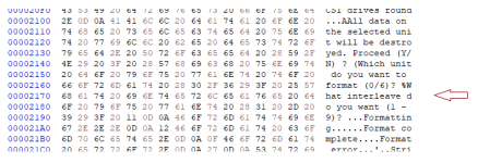

I no longer get an interleave message. System just hangs after finding scsi driveI mean the screen where it is prompting you for the interleave option; I've never seen a SCSI format utility that does that!
Yes that's what I got entered 5 and system hungLater versions of the Seagate ST02's BIOS are at [here].
If I look in version 3.2 of the BIOS, I see what I presume is what the OP is seeing:
