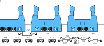

Some notes on my very slow work:
I bought an IDC 10-pin connector for the video output connector BM. Now the question was which pin on the flat cable was on the BM connector.
With a handheld scope I guess I found the CC (line and page synchro), the grey composite output, and ground (or no signal) pins.
At the place of the RGB signals I see:
- A weird signal with short positive pulses at hundreds of kilohertz.
- A signal that looks correct like composite video (I thought it was a TTL-like signal?)
- No signal at all.
So a minimal strategy could be to reuse only the grey composite signal, what do you reckon?
I guess some of the transistors VT2-VT5 are broken, do you know a Western equivalent?
