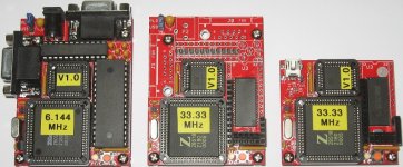

Serial ports are only via USB on this design. One of the primary objectives was for it to be SMALL and cased. Unfortunately many connectors are quite bulky and two DE-9 connectors would be nearly the same size as this entire system.
This design is a follow-on to a prior design of mine that had the option of TTL, RS-232 or USB for the serial ports. There is some documentation on that system <here> and if you're interested, in addition to fully assembled / tested boards I also have full kits of the TTL/RS-232 system and/or the USB system, both of which have the few SMD's pre-soldered and only requiring through-hole soldering. I also have assembled and tested IO2 demo boards but no kits or bare boards since it's mostly SMD, including a CPLD, and some are fine-pitch.

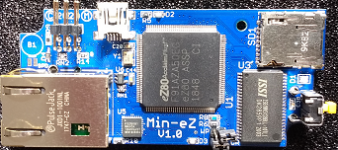

The cased system in the auction was also the inspiration for a small eZ80 system (3.15" x 1.57" x 0.79"). Current status is that the hardware has been verified and I'm well along with the BIOS development.
