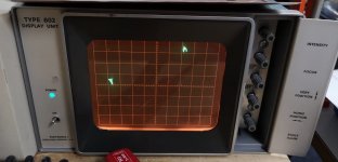

Today I got the SPACEWAR program for PDP-11 that Bill Seiler and Larry Bryant wrote in 1974 working on my PDP-11/05.
The implementation that Bill and Larry did was made for AA11 and AD01 while I only have a AR11 board. The AR11 has 10 bit D/A converters while the AA11 is 12 bit. The AA11 is 2’s complement. The AR11 is not.​
I had to do some adapatations to get it working.
Though I am not 100% sure I got everything right since I thought the sun was supposed to be in the middle. But it is not when I run SPACEWAR.
I got the original source code from Bill Seiler as scanned listing printouts. Then I transcribed it, built it, corrected errors and repeated untill the produced listing was identical to the pdf files.
All code is on my github.

Seems something got wrong. I really believe the sun should be center. Maybe something in the whole code conversion for the 10 bit dac?
But apart from that detail, this is *really* cool. Nice work!
You are absolutely right. It is my bad. I thought about it a bit more and then I got it. The code change for 10 bit DACs is trivial. Just two ASR and a ADD. But I added octal 0400 not 01000. I am pretty sure it explains it. Got to try it later on today, after work.

Hi Mattis,
I've got your modified Spaceware running on my 11/10 with AR11. Now I have to make something with a few joysticks. Fun to see the ships flying around. Thanks for all your work!

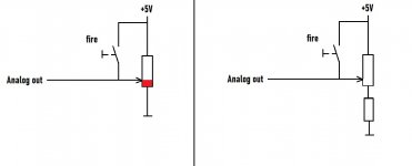

Another thing which got my attention was the fire button. When I read your description I think you want it to be connected like the left schematic. There is one problem... When the potentiometer wiper is at the near end of the potentiometer, there is a relatively high power generated in the potentiometer when you pull it to 5V with a switch. Or even a short circuit when the wiper is at the end. So I would suggest that you use a current limiting resistor in the GND. Or maybe use a separate wire with its own pull up or down resistor to a AR11 input for fire.

For the fire signal I think you are sort of correct. It depends on what kind of joystick you use. Mine are 5k but since the full range is not used they will never go down to short circuit with ground. I should improve the description so it clearly state that one should be aware of this when choosing the joysticks. The ones I have linked to are not full range and will work without any problem. Model M1 goes from 1.8k to 3.6k. If you select model M2 for example you will get into trouble.

You can add a resistor with the same value in each end of the potentiometer for acceleration in case it is a full scale potentiometer. 1k or 2k perhaps.
