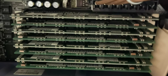

So the machine arrived (with HUGE dust issues I am cleaning away), it powers on OK and I can get to the OBP (which is a relief), the FCAL drives have not yet arrived as were sent separately, I booted OpenBSD off the CD drive and it stated was a "Schizo 1.0" board, so probably an early board.
Good news is dual CPU's which I removed, cleaned dust, torqued back in - not sure of speed though but I suspect the slowest.
Also RAM Issue?
Can't find any net references to this RAM unfortunately.
System on boot (with a TYPE 6 USB keyboard) up says though 512MB RAM.... (and a USB issue, although the keyboard seems to work fine)
I will need to troubleshoot as I am sure the RAM is greater than 512MB unless they are 64MB modules....

Are the rear USB sockets okay? Since this was a deskside machine the cables plugged into the sockets tended to get kicked by users and could break quite easily. Oh and BTW when upgrading your memory modules try to get the same size in the two banks. The machine interleaves the modules in two directions, I remember being caught out by increasing the ram modules only to find the machines ran slower.
The machine came packaged not really well but adequate I guess - one of the RAM modules was even dislodged so it must have had a rough journey.... however it seems still intact - they are built pretty well it seems.
I'm plugging the Sun keyboard into one of the rear USB sockets, when I get home I'll check if it has become loose.
I will also take out all the RAM tonight and check it out... it is very likely though I will have to upgrade it to 8/16GB as a first step, but thanks for that advice as I will use it when buying RAM!

I think the Dataram was faulty as using just these four modules alone in Bank 0 gave me four beeps and no boot up. Replacing them with the Samsung 128MB modules gives me 512MB when used in Bank 0 after I swapped them over and no beeps/errors.
I also found out the CPU's were 750MHZ each. Next steps, install OpenBSD on one of the (72GB/10K) FCAL drives when they arrive. If this goes smoothly I will upgrade the RAM and eventually upgrade the CPU's and put in a SAS card. The final topping of the cake will be a Sun CRT 22 inch monitor from the early 00's.
